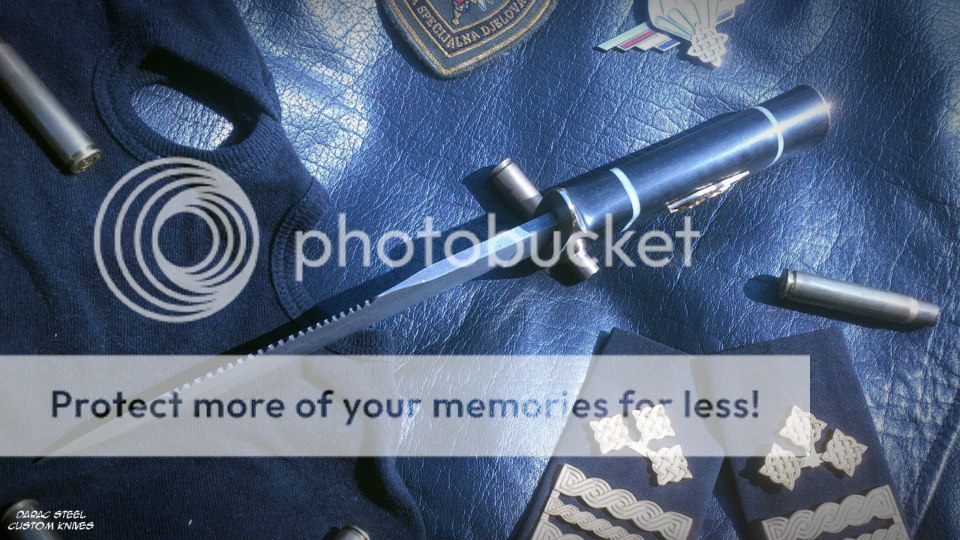

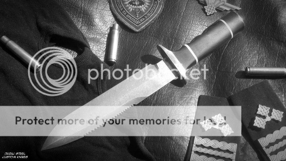

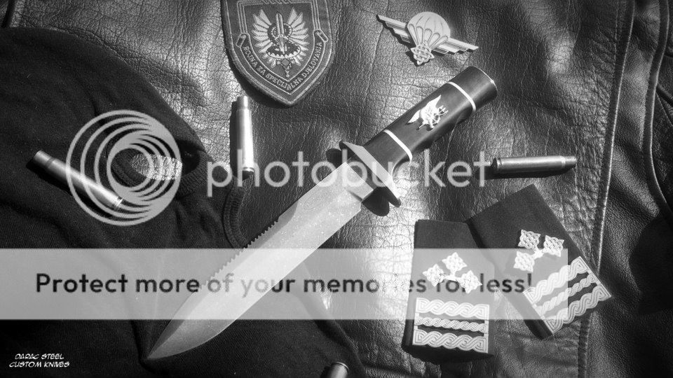

Hello everyone!
Here's my new knife Warfighter
I love this style of knives, so I present my latest work....
Blade Length - 190 mm (7,5") x 5 mm (0,196")
Overall length - 305mm (12")
Blade Steel - AISI 5160 - carbon steel
Blade Finish - Acid & stonewashed
Handle Material - Black ebony & camel bone
Brass double guard and butt plate
Gold plated US Navy SEALs badge
Sheath coming soon...
regards !

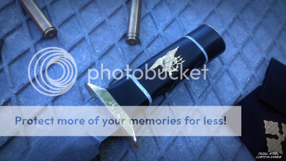

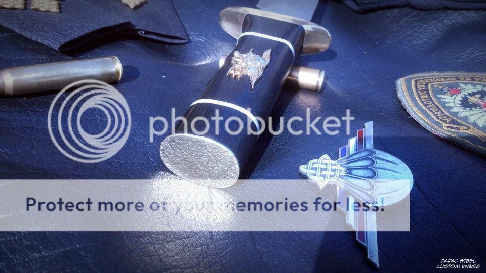

Very nice and love this style of knife.
However, unless this is a presentation/ornate piece, I'd rather not have the Seal Trident on the handle as it's currently laid out. Perhaps 'sinking' the logo in the handle but as it stands I'd say that would either fall off or cause a LOT of pain to the fingers when being used.

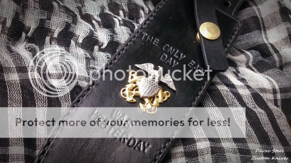

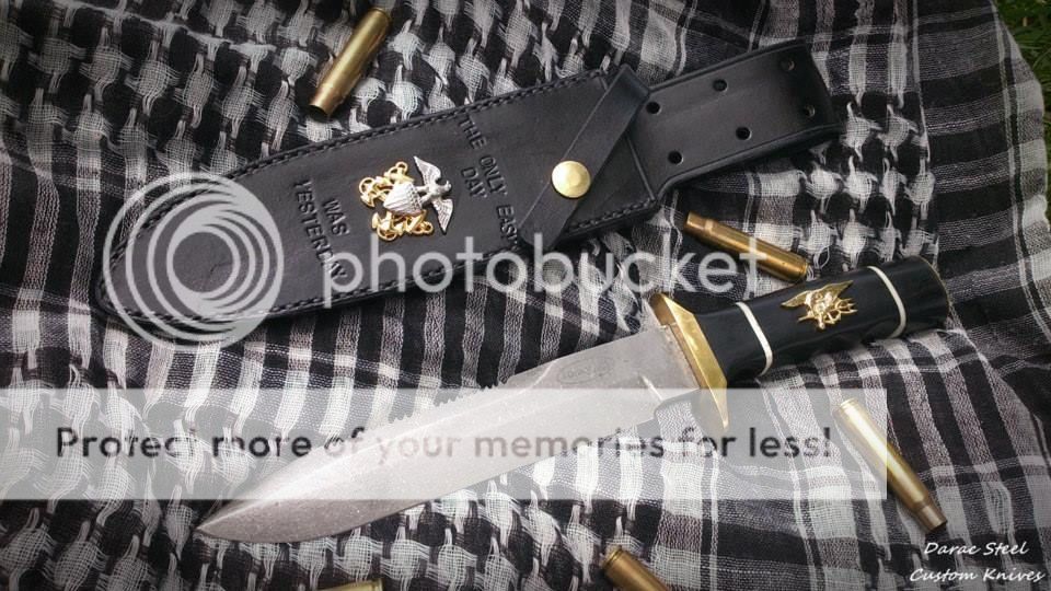

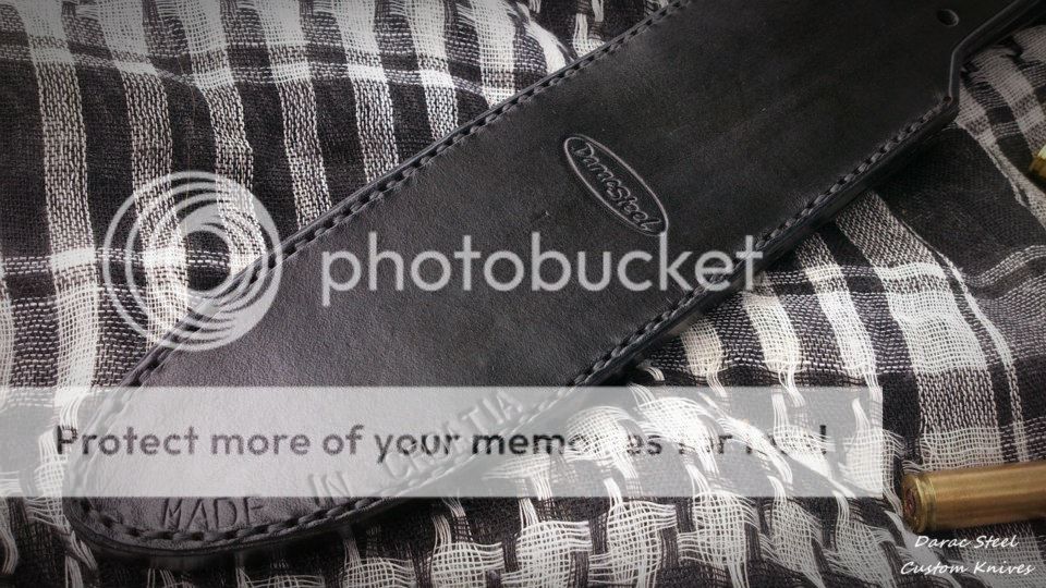

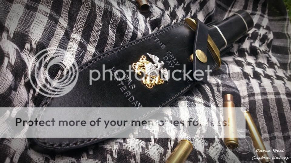

Finally got a sheath!
It took so long until the badge came from America ....
I must say that I am very pleased with that how it looks in the end!
Here's some pics ...
