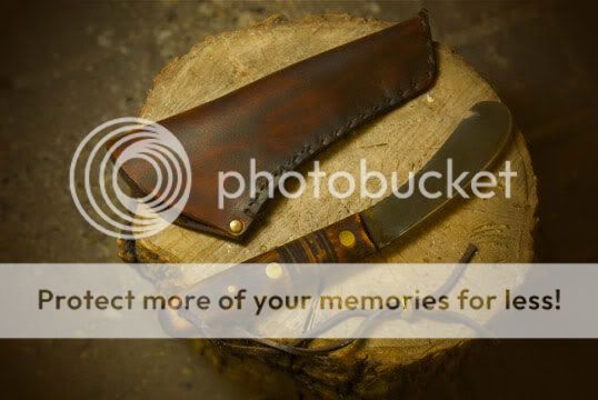

I've done cold "black oxide" finish, ferric etching, and parkerizing... but so far my favorite has been paying someone else to do a professional black oxide finish.
The parkerized finish can look chalky and un-even (the tint changes based on steel hardness levels). Pics on my site show parkerized spikes and knives.
Note that there are two kinds of parkerizing solution; one leaves a grey finish; the other, black (like Blindhog said).
The black oxide finish is more durable, sleeker (bead-blast prep as opposed to a sandblast prep), and much more consistent in appearance. AKA hot bluing.
I just put this finish on some old Dexter knives that I re-made. I just poured muriatic acid from the hardware store on the blade and let it sit for an hour or so. Might not be what you are looking for though...
