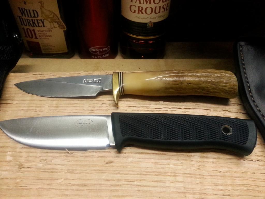

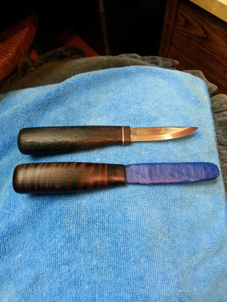

I read somewhere that potassium permanganate was(or still is)used to disinfect Sambar stag before being imported into the U.S.I appreciate your input on this forum Mr.DeShivs,your advice to others on solutions to solve a problem has always worked when I have tried it.I used potassium permanganate to highlight the grain of the tiger maple in these two Mora blanks the darker one was exposed to more solution the wood was from the same chunk.Soaking stag that is really white where the bark has been sanded in coca-cola will turn the light areas a light honey color as in the stag in the other picture.
Honey colored stag
I read somewhere that potassium permanganate was(or still is)used to disinfect Sambar stag before being imported into the U.S.I appreciate your input on this forum Mr.DeShivs,your advice to others on solutions to solve a problem has always worked when I have tried it.I used potassium permanganate to highlight the grain of the tiger maple in these two Mora blanks the darker one was exposed to more solution the wood was from the same chunk.Soaking stag that is really white where the bark has been sanded in coca-cola will turn the light areas a light honey color as in the stag in the other picture.The other handle in the pic with two Moras is Irish bog oak.

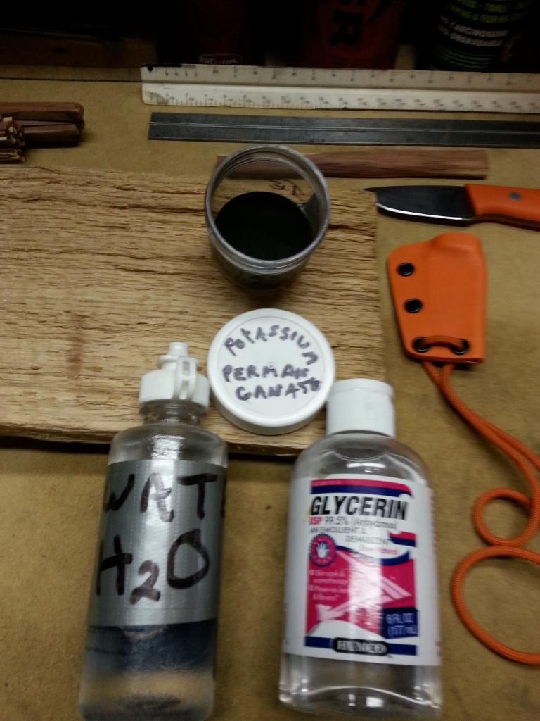

P.P.is a disinfectant,used to treat water with high iron content,dye when added to bottle on left(water)and when mixed witu the right bottle(glycerin)and if temperature is above around 60 dgs or so it ignites and burns with a vengeance for longer than you thought it wood.

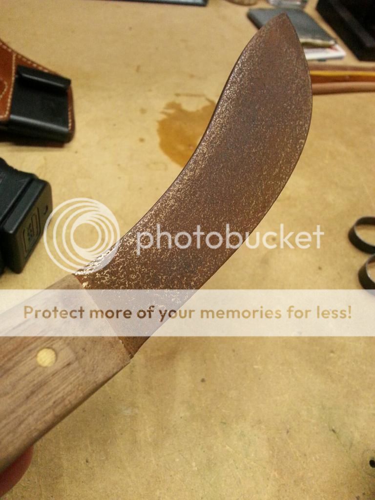

Found a regular home peroxide less than ten pcnt heavily salted and brought to scalding temp would give metal a brown finish when rust rubbed with denim put back in mix and rubbed again and repeat til desired color reached.The high pct stuff gets same heavy dose of salt but no stove necessary since it will boil from heat generated by metal oxidizing and I did not rub as much with denim since a rougher finish was what i wanted.I hear peroxide and kerosine mix is rocket fuel.
