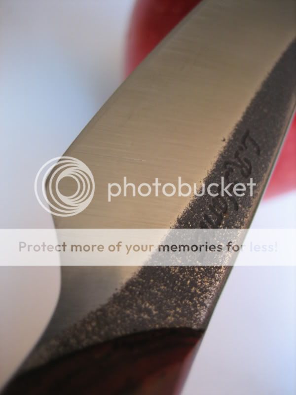

Not sure what he did but...
Butch Harner (of Harnerknives.com) did this paring knife for me in S30V.
It's just not "finished". On most knives, the steel looks like that after heat treat, then it is satined. That one just wasn't except for the edge grind. It's a "rustic finish" so to speak.
Which is one of my favorite knife finishes BTW!

I used some naval jelly on some stainless to find it etches some types pretty well. It doesn't come out black, but a matte non reflective gray, which may be a good base for some kind of coating.
I used naval jelly on the handle of a Kershaw Chive to get rid of the slippery bead blast finish, giving it a significantly grippier, dry feel, almost like an old blackboard.
I dug up this old thread on what I did.
Corrosion has not been a problem with either knife. The Mora even survived several weeks living outside in my back yard getting a nightly spray from the sprinkler with no corrosion at all.
I've used ferric choride on hardened 440A and a benchmade pocket clip, which I'm assuming was 420j2 or 300 series. In both cases the ferric gave both a dark matte finish alot like black phosphate in appearance. I actually let the benchmade clip soak for a while and it came out looking like a rough blackened beadblast. Can't remember the concentrations I used but I think the clip was something like 50/50.
