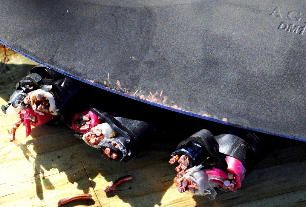

And cutting through power cord..
Performace was excellent, zero edge issues, no chipping or rolling, edge retention is good as the knife will still slice phone book paper at this stage. Balance is good for lighter chopping as it's a 7" blade and pretty thin spine thickness and 13.1 ounces.

I like the cutting of the copper, doing it repeatedly is a good test of edge toughness. I got some really funny looks from some folks in the Home Depot parking lot in Tampa in 2012 when I was doing the T&E on the A.G. Russell Sand Box Bowie. I went in and bought 4 feet of copper range wire and a section of 2x12, then proceeded to chop the range wire into pieces in the parking lot on the tail gate of my truck. Lol, I had a decent crowd of spectators by the time I was done :D

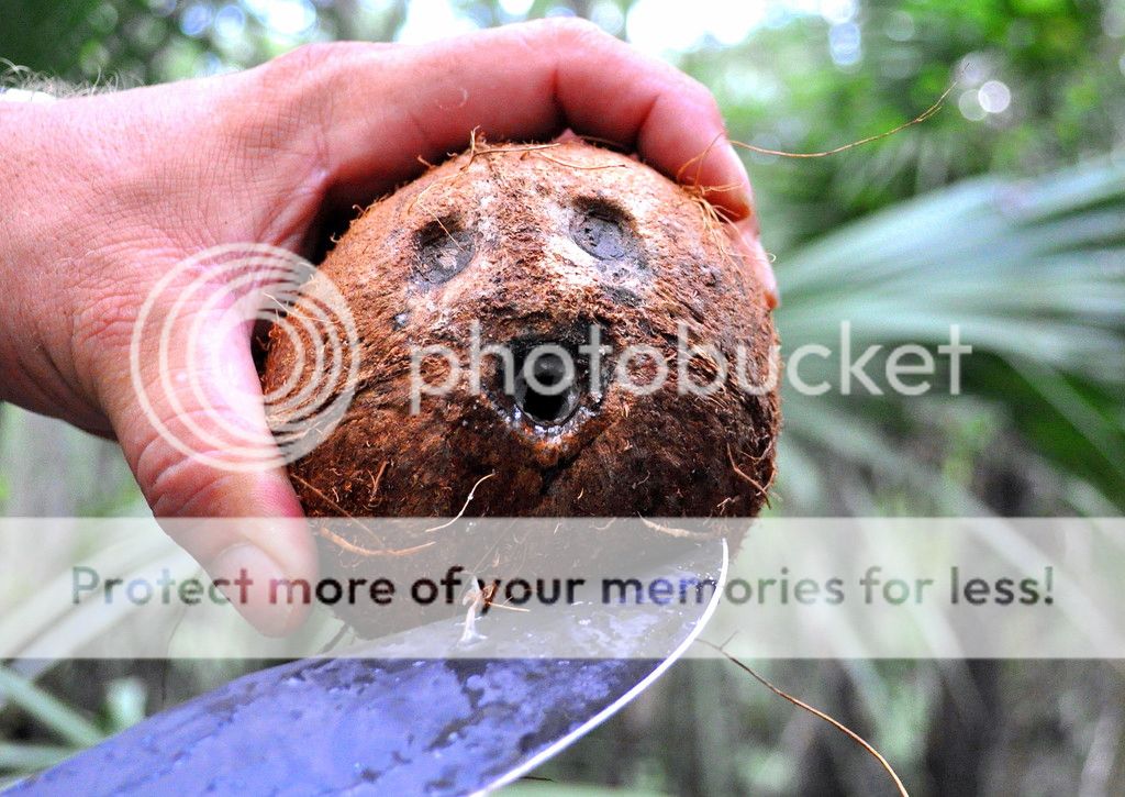

I got a few laughs out of doing the tests on that knife. I was initially worried that my editor would say I was taking the knife beyond reasonable expectations. I even thought I was on one hand, yet not so much when considering the target market for the tool. The the heat treat and quench on that DM1 handled it well enough though.
As it turned out the one problem photo was a demonstration of using the tip to bore into a coconut to access fluids for hydration. Apparently that one unsettled the art layout guy by appearing too "violent" and he refused to publish it lmao

I don't see the coconut thing as a problem, it's a good test I think.

I didn't expect it to be an issue. Hydration is an important aspect of survival. Seemed like a good area to go into to me...but people can be funny. I think you get where I was coming from with you being a traveled veteran and all. I'm glad someone else out there besides me gets the idea behind it.

Awesome review, that's a solid performer, I'm shocked it took no damage from the wire.
I'm really not surprised by that. The data is there on how to make tougher edges with various steels. You just see the better results most often with hand made knife makers. The processes are cost prohibitive to mass production due to the time consumption and painstaking-ness of it. Most factory edge are small hollow grinds done on the outside of a contact wheel even when they are fragile due to overheating they are fragile due to the geometry. In my experiences, most mass produced knife edges are significantly more durable after the geometry of the stock edge is changed by normal sharpening or a re-profile from the outset. These are some of the reasons I go to knife makers I know and trust when it comes to the knives I take to the field and may have to depend on to stay alive. Whether they make the knives one at a time or in small batches, they spend a lot more one on one time with the knife, and painstakingly craft it to what it is supposed to be.
