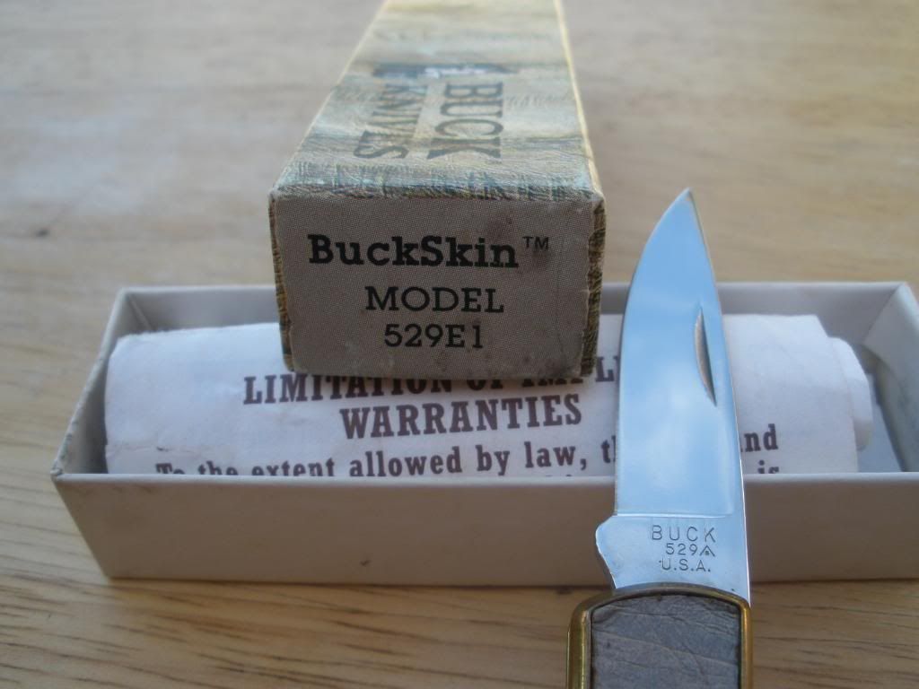

I just bought a 529 and it has an inverted V next to the 529 but it has a . (dot) inside the inverted V) is this still a 1988 production?:confused:
mb,
Might be a test hole for hardness. Howabout a pic. I dont think 529's went by dot but I dont see them in any catalog before 1988.
I'm going to say yes...here's a pic of one that I asked about sometime ago, IIRC was told that it, the dot, was for a change in the design/engineering of the model during the production year. HTH, Preston
pjsjr,
that is exactly what it looks like and sorry I haven't received it yet, got it on the bay for $9.99, in mint condition, Ill post pics when I get it but, if I understand your remark it means that it was a design change during the production year? these were originally produced in '88 according to my '88 catalog.
MB, Yes, I think pj is correct as thats the way I recall . Perhaps, your thinking why was there a design change the same year it was first produced ? Well, we've discussed this a lot here and it is many reasons . It could be a mid-year change on the frame material/steel or pivot bushing or lock bar material, ect.. There are many models with the stamp you mention . Joe H. wrote an article on this subject several years back (I'll try to get you the issue) and I remember the list of knives/models was extensive with a odd stamping . His conclusion was that some of them they knew what the change was but most of them they didn't . Several, models come to my mind that required changes after they were introduced . The 700 series (lock failed) the Sawby (lock failed) 110 (bushing change) ect.. DM

Here's one... Same mark... Got mine for less... don't tell no one... :eek: ...
I remember those discussions and I don't think a definite conclusion was drawn.
In the article that Dave mentions, Joe said he didn't have a clue why the dot was on his knife (I believe Joe's was a 110).
So.......I don't see why it couldn't be a Rockwell test as Fritz suggested.
If anybody knows of a thread or article where a definite answer was given on this question, please post it or a link to it.
