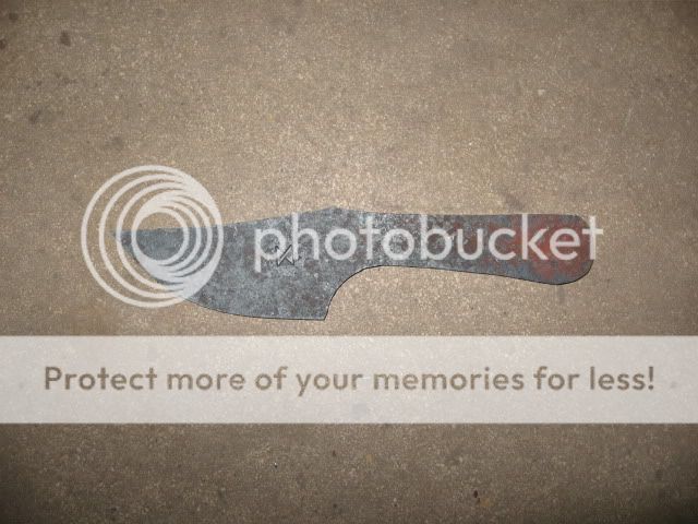

A member of another forum who goes by the handle Dawgboy approached me with what he wanted in a knife, and we got down to designing it. After he saw my "primal/tactical" knives, he decided that he wanted a cord wrapped handle. He got to see a sneak preview of the scavenger blades that I posted recently (made from plow disk) to see the new style of cord wrapping and decided that he liked it. I used one of the hunters as a starting point and drew out a sketch, widening the blade and giving it an upswept tip. We made one alteration to it, and he gave me the go-ahead.
Here's what it looked like after I had it blanked out from a piece of plow disk. This is a stock removal blade; the only forging done to it was taking the curve out of it from being a plow disk, and stamping my touchmark in it.

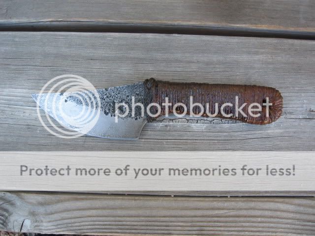

I soaked the blank in vinegar overnight to clean the scale and rust off the blade while leaving the beautiful rust texture in the steel. After grinding, heat treatment, and wrapping the handle with hemp cord over leather slabs and a cotton Turk's head knot sealed in amber shellac, I sharpened it to shaving sharp. And this is what it looked like just before I packed it up and sent it.
