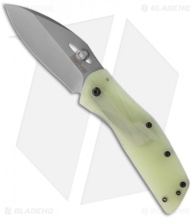

I actually want to try it with a Kershaw Grid, the spring broke out of the blue, so I thought about drilling a detent hole and see if it works. *makes a mental note to remember and take the blade to work tomorrow*

The best de-assist experiences I had were with a Benchmade 581 and a Kershaw Echelon. The stock Echelon is garbage - mine was stiff and had bad centering - but once the spring came out, it was a very smooth knife without mechanical problems. I saw it as a budget Strider Baby Huey substitute. Shame the model never got much attention.
