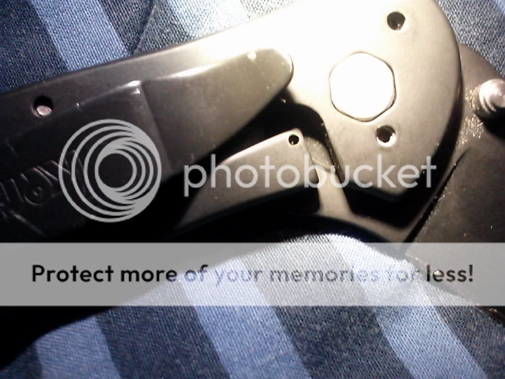

You can, but it has no detent ball so you would have a floppy knife. The torsion bar acts as the detent on the Leek. If you're still interested in trying, you would just have to unscrew the handle and remove the torsion bar.
Yes, it does.......It just doesn't have a hole to go into though.
I'd advise against it. Check out the Salvo/Barrage instead, but its not a flipper.
I just checked, my leek doesnt have a ball *shrug*
I assure you, it does.
If it didn't have a ball, one of two things wouldn't be in the picture.
1) A hole for the detent ball wouldn't be there
2) There wouldn't be a groove on the blade, that's shown in between the lockbar, and the frame in the picture.
I de-assisted my Leek and liked it a lot better. You'll have no issues with the blade popping out or at least none that I experienced. The torsion bar goes back in very easy.
you can, and I have, and after about 30 seconds I put the torsion bar back in, it will just flop open, and you need a wrist flick since for me the blade protrusion doesn't quiet protrude far enough, just my experience
I don't know than, i assure u, mine is ball freeuhhh... Nope, nvm :o it was hiding under the clip its the dlc one and i don't have good lighting, and im lazy :o :)
