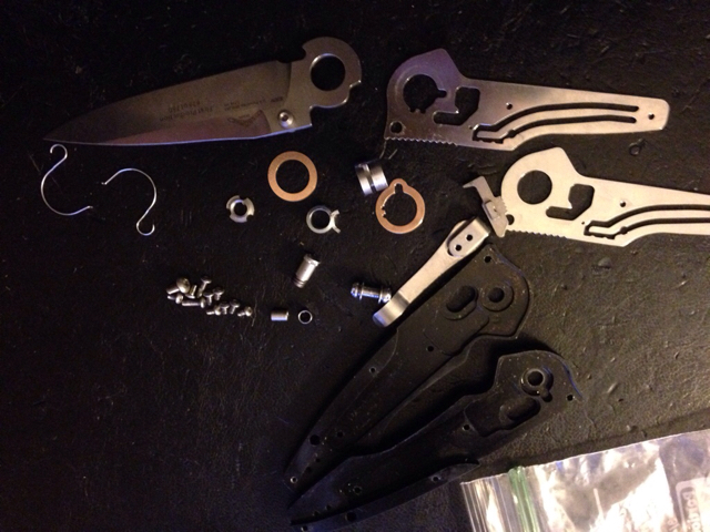

So I have a 477 that has been collecting dust and decided to de-assist the knife in hopes of more pocket time..
Well, I will warn you unless you have rocket science degree in engineering, it's no joke. The removal of the coiled spring is not that difficult.. Where it bites you is when you remove the inner barrel that holds the washers and when trying to figure out the maze that the barrel has that fits the washers. :eek:
The assist is built in the pivot, with washers that have groves and teeth, its a real jig saw puzzle.. The pivot has tons of parts and after about an hour of it, would love to kick jonearlt in the nuts, 2x..:rolleyes: Seriously, why make this so complicated:confused:

However, your descriptions are unclear to me.
Could you take some pictures?
LOL.. I was pretty frustrated when I wrote the description.. Probably makes no sense..
I am fairly mechanically inclined. Not a master Tech but do have a associates in applied science in Motorsports and Marina. Took it just for kicks to work on my bike and watercraft's.. But I do fix and open up a quite a bit of stuff, so not a complete idiot.
I did get it back together, I just had to take a break before I get :grumpy::grumpy:
The inner barrel that holds the pivot has machined groves and directional specific, so it can only fit a certain way, which makes the install of the washers a nightmare. Took be a bit to figure out, but on this knife you would have to split the inner frame and lay them down one at a time vs the traditional benchmades where you would slip in the washers while holding the axis back.
She feels great now. Few other knives that I have de-assisted felt little off with the action but this one feels like a natural.
Awesome! Glad to see you got it. Yeah, thats a different animal than the Volli/Barrage.
I'm glad to hear you've gotten it back together and all is functioning fine. From the pics you provided it looks as though the 477 is quite similar to the 665. Well except the 665 has the added complication that it's push button adds to the mechanism.
