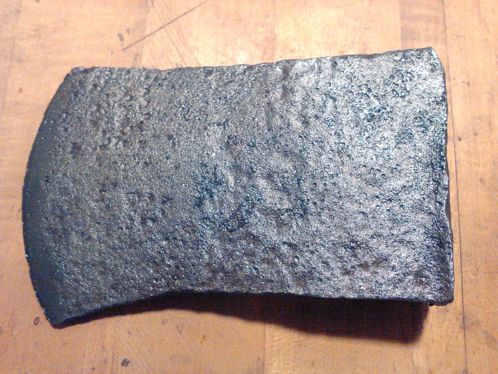

This side had the most mushrooming and as you can see this thing is pock marked rather deeply.
Although the vinegar bath did not show a forge welded bit which I was hoping for it did show that the heat treatment extended all the way back to the front of the eye. I know the heat treatment line did not show in the above pictures but you will see how far it extends in later pics. I was excited and became convinced that I could breath some new life into this boys axe after all.

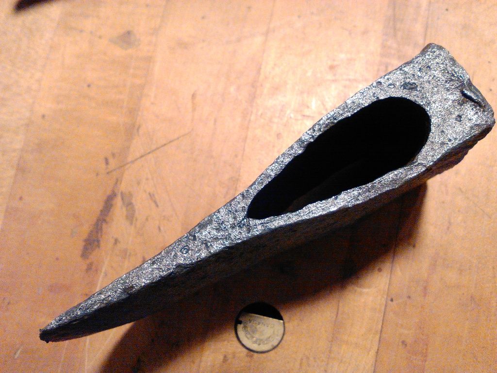

The bench grinder did this bit no favors and left it rather fat.
Pitted poll is fun.

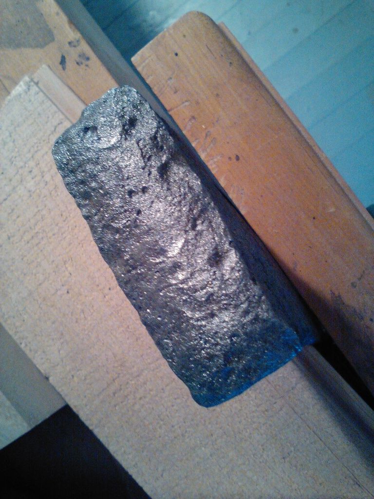

I peened on the mushrooming and was extremely surprised at how malleable the poll was. I was able to pound the mushrooming back quite a bit which was nice because there was no way I was putting the file on the poll of this one.

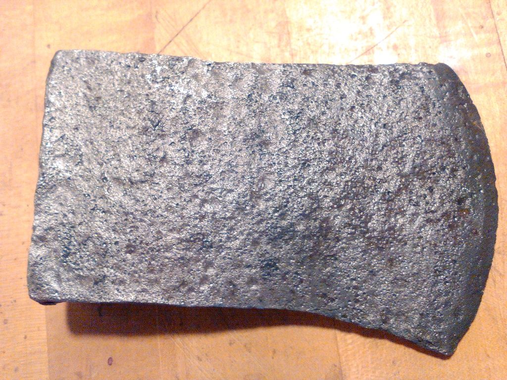

So yeah, back to the filing of the bit and putting an edge on it. I put my new USA Nicholson handy file on it and it really had a hard time at first. I tried my Simonds multi-cut on it and it skiddered right across the bit. The Simonds has cut a lot of metal though so I think its getting tired. As the Nicholson got started though it began to cut nicely but right on the edge of chatter. Once I got down to where the file was cutting smoothly I switched up again to the multi-cut and it just would not bite. So, I did the thinning of the bit and cleaning up the edge with the handy file. It was quite handy and got me even more excited about bringing this one back to life.
I am not sure why but I have a strong draw to this boys axe.

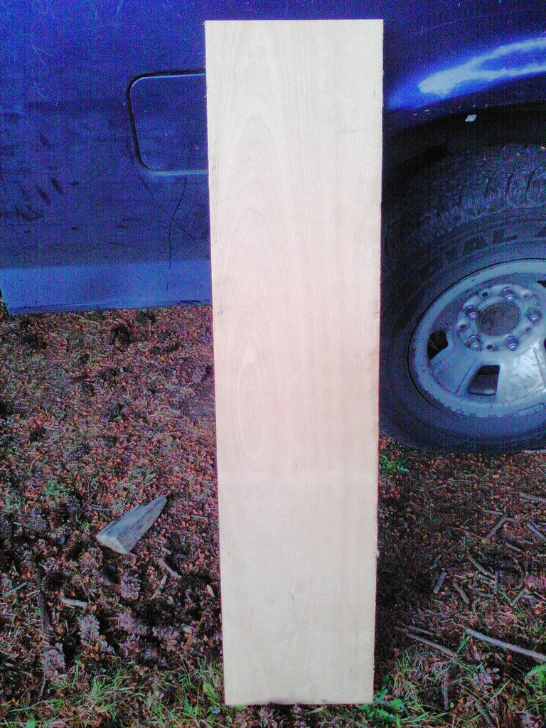

I was recently gifted this hunk of beech. When I first saw the flat grain I knew I wanted it for hafts since orienting the haft would be so easy.

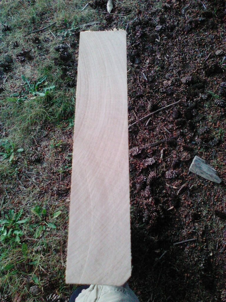

Beech haft it will be.
