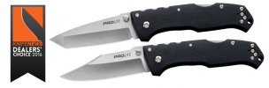

The Cold Steel PRO-LITE wins Dealer's Choice Award!
KnifeNews announced today that our PRO-LITE series won best new value folder for 2016
We're really proud of that!
To find out more and read reactions from our team, check out our blog HERE
To celebrate we're offering buy one Pro-Lite, get one half price* at www.coldsteel.com from now until Sunday!
