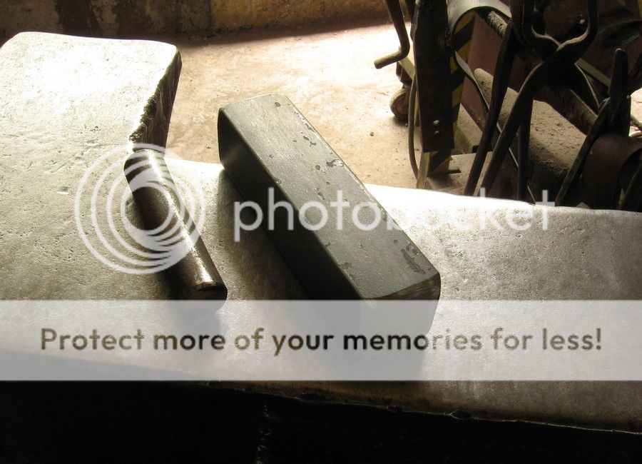

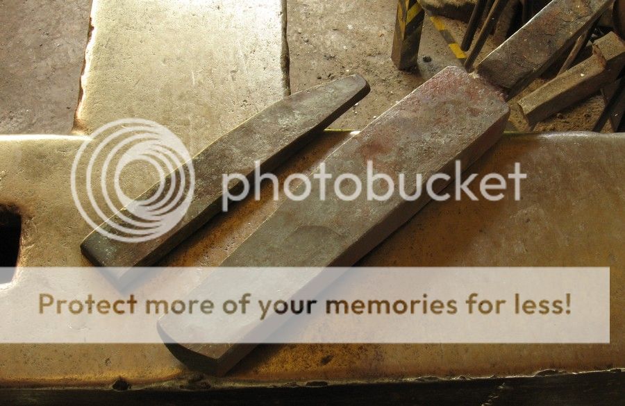

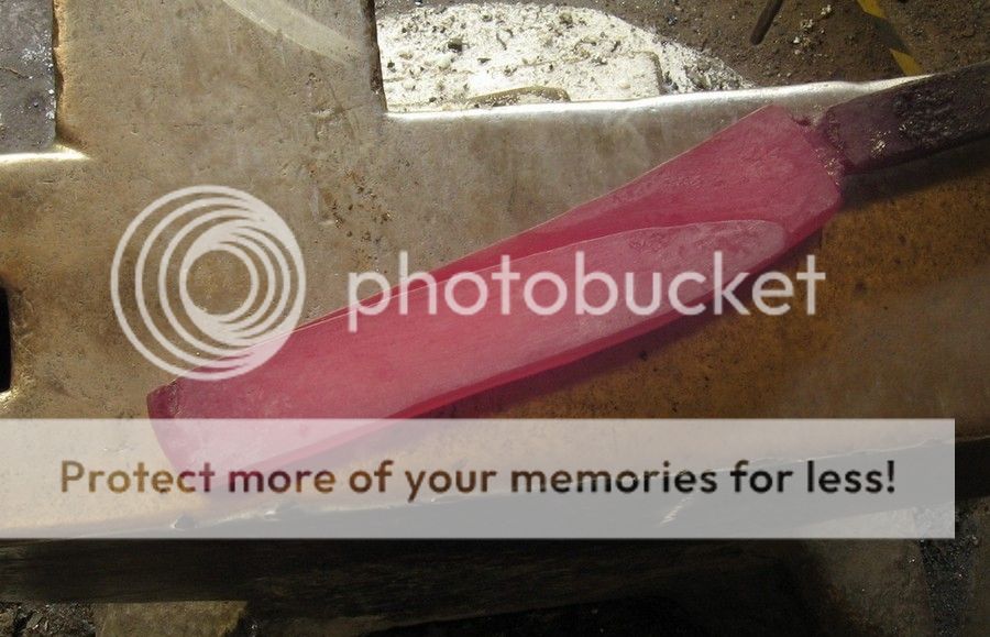

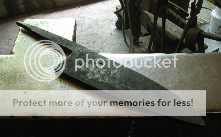

Starting with silver steel and iron and forging them to shape
Since I have a small power hammer I couldn’t do the tang traditionally, knife and hot cutter together don’t fit in it so I had to cut it with angle grinder. I never thought i’d make these type of knives when I was building it.

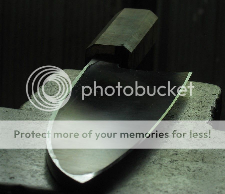

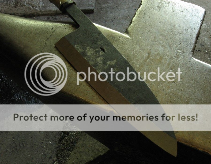

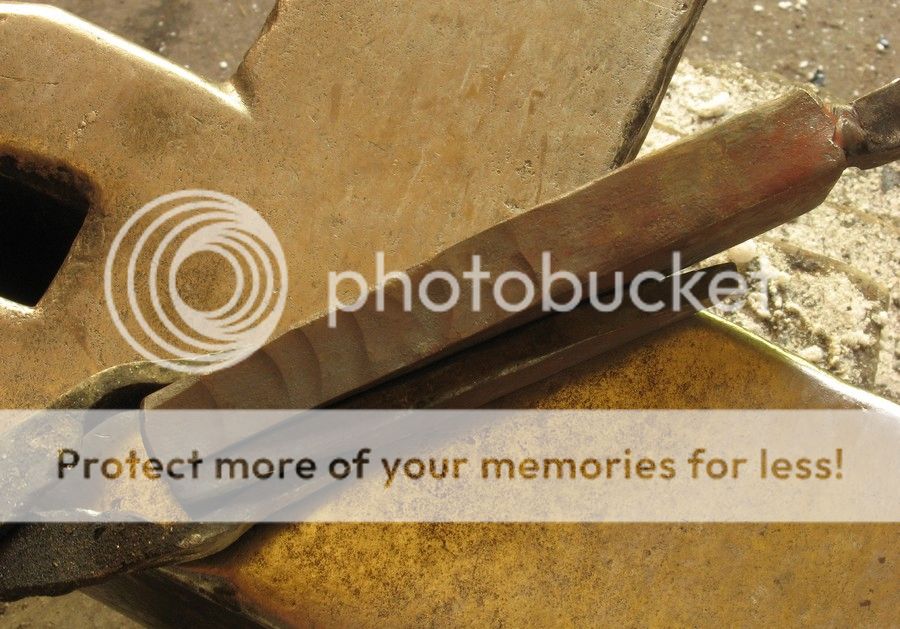

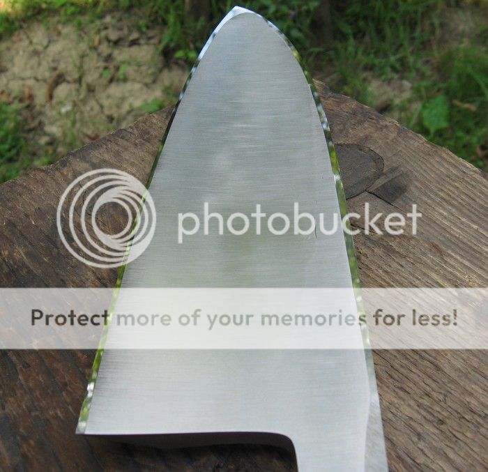

Forging ura side concave saved me couple of minutes of grinding

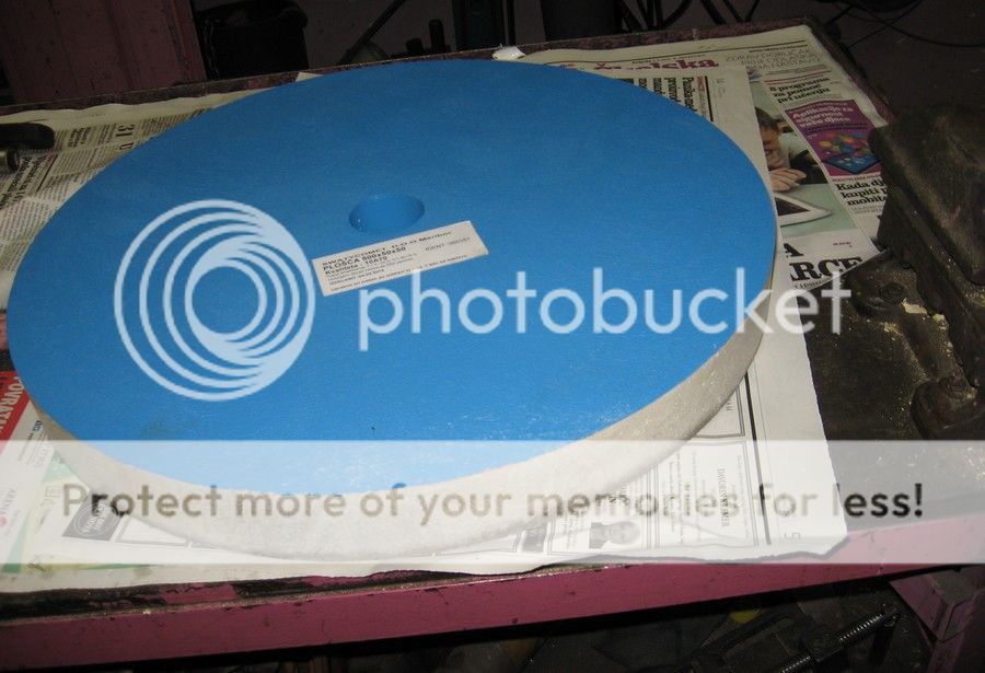

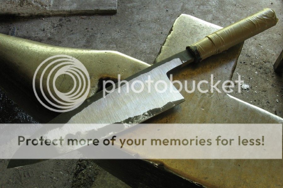

...and the grinding on big whetstone (20 inch) after HT has begun.
This is it for now. Thank you for watching.

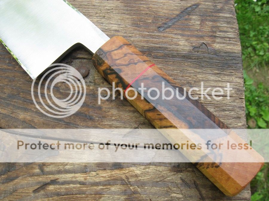

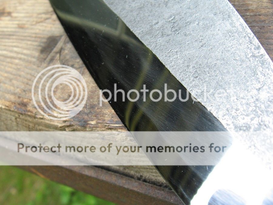

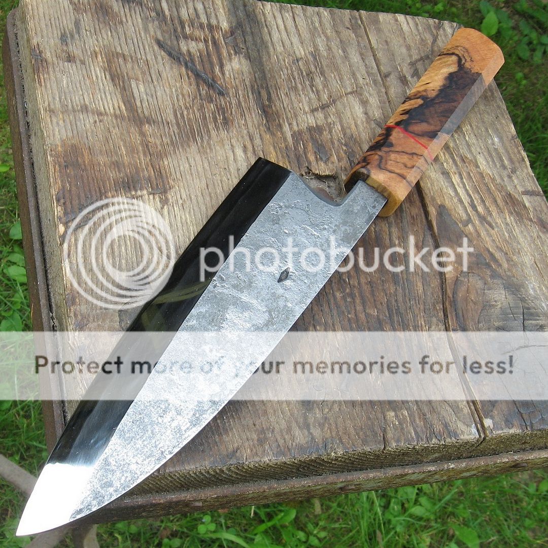

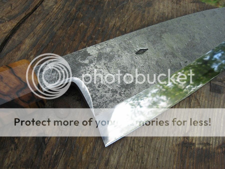

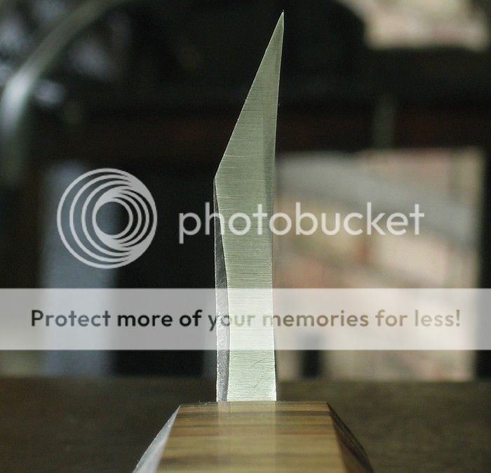

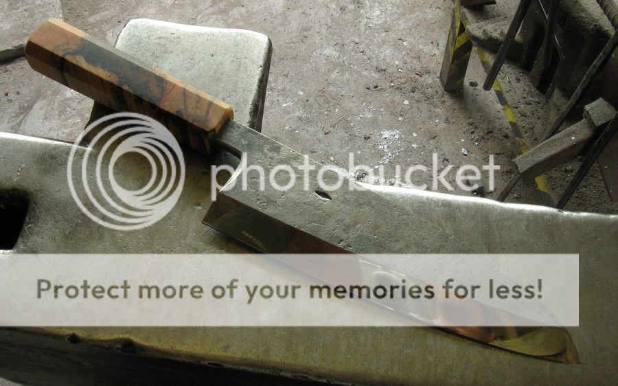

Pictures of the finished 8 inch deba taken after lunch, beer and a nap.

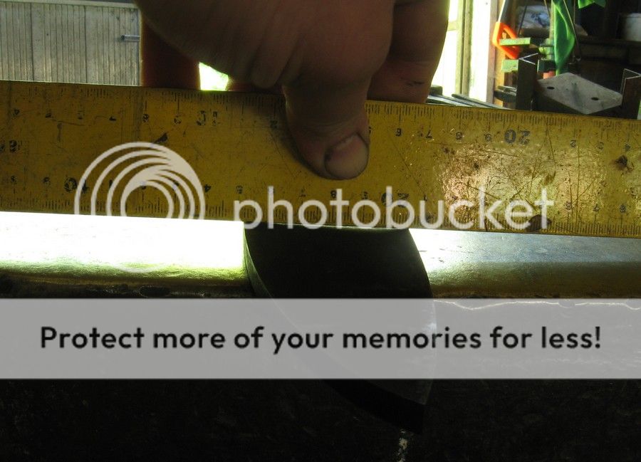

At heel primary bevel is 22 degrees and at the tip it is around 19 degrees. Secondary bevel at heel is 10 degres and it almost disappears at the tip.
Hope you guys like it.
Fantastic grinding and overall fit n finish, well done. I feel a silver spacer would fit the piece better, but I still like the red
Great job finishing that up.....beautiful polish and sharpening. :cool:

Very nice work Karlo! It would be interesting to see the wheel you cut that urasuki with. Also, I hoped to see your yanagiba work on Instagram. :)
Thank you.
This is the stone (first from three that I already worn out):
It is from Slovenia and it’s 80 grit. It removes material like butter. It does wear out very fast but it is also cheap, less than 300 USD.
