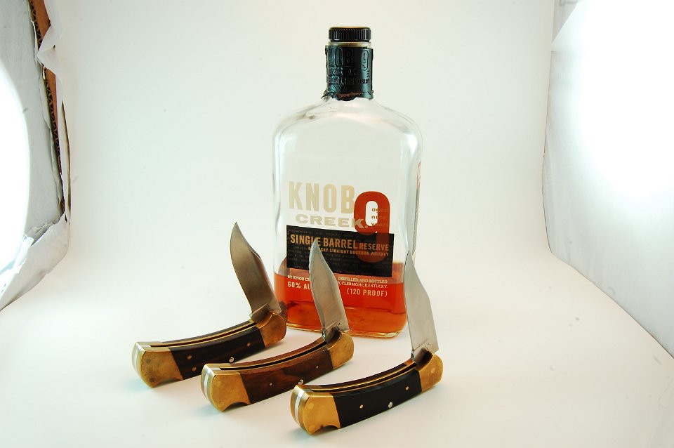

A few years ago Coop (one of the top knife photographers in the business) showed up at
an unofficial ABS hammer-in up in Vermont. He had a long table with two lighting set ups.
On the left is the cheap box he taught us to make out of foam core board, PVC pipe and
a sheet of artists velum he was kind enough to give each of us (use a white trash bag
if you can't find the velum). On the left is his professional setup. You'll notice it isn't
that much more elaborate -- the most expensive part of it is the set of old used studio
strobes he bought on eBay instead of the cheapie daylight fluorescent lights he had
us buy at the local big box.
After showing us how to build this he then took some picture using:
  • His pro level Canon SLR
  • His pocket point and shoot
  • A really cheap point and shoot someone in the audience handed him
We could tell the difference, but even the last picture was way better than any of us was
taking before!
I then went up with the camera I was carrying and took this picture (my camera was a Canon
Digital Rebel SLR -- i.e. the low end SLR).
Yes, a simple, cheap light box really makes more difference than the camera
you use.

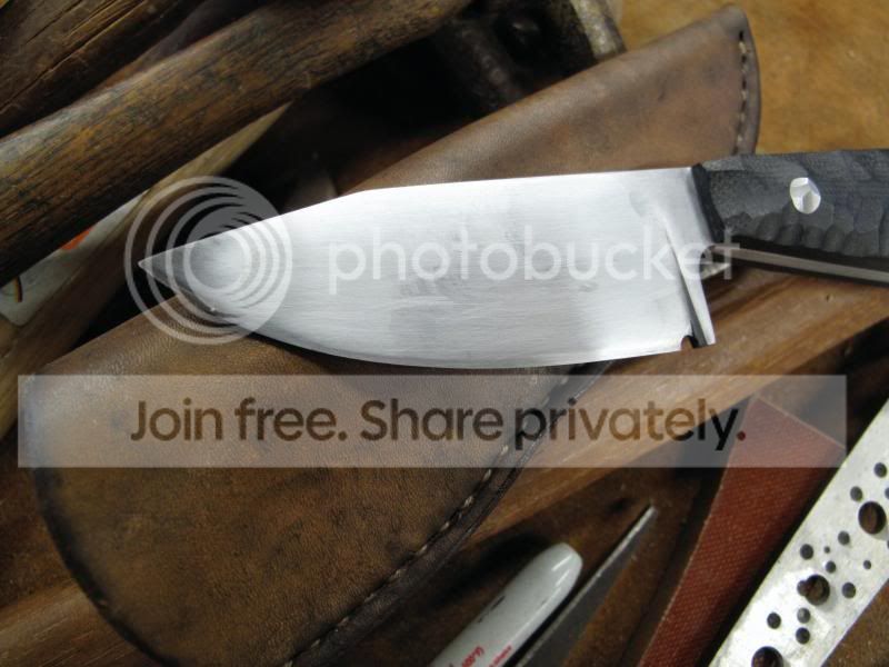

A few years ago, after reading through the above link, I bought a Canon G10 to replace my Pentax SLR. It's not as small a Point-n-Shoot as some might like, but I needed something bigger to better fit with my big hands. All of the little cameras I tried out at the store were designed, it seems, for schoolgirls to tote around. My big paws couldn't get to the buttons without practically dropping the thing!
Anyhow, it has proven itself time and again. Great camera with great clarity and plenty of room for me to improve. I love that all the dials are there instead of having to sort through a dozen menus. And, it takes a great picture.
Here's one that I took free-hand, in my shop with just the shop lighting. The blade was waxed because it was going in the mail.
Not bad for a camera that's small enough to fit in a pocket!
