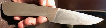

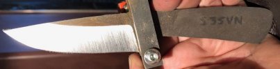

I have ground 2 sets of bevels with the bubble jig. Same profile of knife, but one is ground using 10, 5 then finally 4 degree angle on the bevels and the second one I have only ground to 5 degrees.
In another thread someone said it was personal preference where I stopped. But is there advantages to one over the other? A bit more material removed on the 4 degree bevel so knife is a bit lighter?
Any other reasons to go to a 4 percent angle on the bevels?
Also, I ground these using 60 grit first. When I go to 120, 220, 400 about how many passes should I be making at these grits? 3-5....until I get rid of the scratches from the previous grit?IMG_1435.jpg IMG_1434.jpg
The lower the main bevel angle the thinner the blade near the edge. Slicers are generally thinner, heavy users and camp knives thicker. 4° or 5° are both good.

As stated above but more clearly IMO, the more acute your angles are the more slicy. The height of the bevel may not always have to do with the slicyness as the same angel will change height with different thicknesses of the stock your working. Try a bunch of different angles and see which one cuts good for the task you want that is also strong enough, keeping in mind the thicker the spine will reduce the cutting performance as well.

When someone with a lot of experience told me, when I ask him about sharp; "it's what is behind the edge that counts. How much resistance to slicing is there when you cut a tomato. If the portion of the bevel directly behind the cutting edge is thick, the knife will not slice well, if the steel right behind the edge is thin, the knife will slice well. There is no real edge. The edge of a knife is where the bevels meet each other. So to say an edge is sharp is really saying, the steel "behind" the edge is thin and the angle of the two bevels is acute. If you ponder this a while, it will make sense. If you have a set of micrometers, measure the thickness behind the edge when you have the bevels ground. Remember, there is no "edge" on a knife, it's the steel behind it that is critical.
When choosing how thick a steel should be, to produce a knife that cuts in a certain manner you want to be thinking about, "how thick is the steel behind the edge" after the bevels are ground. This will help you decide what thickness of steel should be used to produce a specific knife that cuts in a specific manner. Or, don't expect a knife ground from 1/4 inch stock to cut in the manner of a blade, ground from 1/8 inch stock.

I will be doing fine with either angled bevel but I can focus in on certain qualities that will be advantages in certain situations. These blades are just 1/8 and less than 1.5 inches tall. I have profiled 8 blades total. 3 pairs of blades and then two others that don't have partners(hope that makes sense). So I think each pair I will do one 5 degrees and one 4 degrees. See what differences there are when I make knives out of them.
