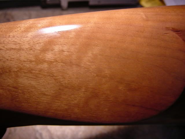

Finishing: I've made a few dozen custom gun stocks using the following technique:
Woodburst oil based stains: sand your handle down to a likeable grit, then wet sand with 200+ grit using Woodburst as your vehicle. Woodburst comes in lots of nice colors. The oil base of Woodburst is natural tung oil. You can put just about any finish on top of it.
As a top finish, I use Birchwood Casey Tru Oil. This is a mix of BLO (boiled linseed oil) and polyurethane. I put enough coats till I'm happy. It will finish gloss, but you can buff it down with 0000 steel wool to a pleasant satin finish. Tru Oil is easy to touch up.
Here's a rifle stock I finished recently using this technique:

That handle looks great, what do you mean by wetsand? Do you put the woodburst on the sandpaper then sand with it?
Also I see they offer them in 2 oz sizes to try, about how many oz do you need for a handle?
The Woodburst 2 oz bottles will usually finish 2 or 3 gunstocks. I'll bet one bottle will finish a dozen or more hawk handles.
Wet sanding is sanding with a liquid 'vehicle'. This is usually done with your higher grain sand paper. You need to buy sand paper that is designed for wet sanding (it will say 'wet/dry' on the package). The idea behind wet sanding is to fill the pores in the wood to produce a very smooth, uniform finish. The vehicle and the dust form a fine paste that fills every nook in the wood. For a vehicle, you can use water, oils (tung or BLO), polyurethane, etc... If you want a really weather resistant finish, try wet sanding after spraying a light coat of Spar Urethane. The urethane is the vehicle. That gives one of the toughest, most weather resistant finishes you can find.
so buy wet sandpaper then apply the finish on the paper or on the wood followed by a sanding?
I apply the vehicle to the wood, but you could do it either way. With any new finishing technique, do some practice pieces first. I have a collection of unfinished walnut rifle stocks that I use for practicing new techniques or finishes. The stocks were factory rejects from Boyd Rifle Stock company (google them). They usually have a 'junk' pile where you can get some practice timber for cheap.
And remember, for a good finish, you need to sand with progressive grits. I usually start with 60, then 120, then 180, then 320. If I plan to wet sand, I usually do that at 400 grit. For really fancy finishes (furniture, etc...), I will even take the grit up to 800. I think that is overkill for a tomahawk handle. That is not the 'perfect' way, but it is the way that works for me.
