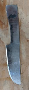

This is my second forged knife and both have the same issue.I am using 1084 steel on a small home-made coke forge and keep getting these deep burns in the steel. I am only heating to just above ACL but both knives had these deep burns. I have to grind form 1/4 inch down to 1/8 in just to get to unburnt steel.
Does anyone have any suggestions on how to keep this from happening?

Here is a picture of the blade
The solution to this is - Don't burn the steel.
Seriously, it sounds like you are really overhreating the steel in forging. Another thing that can mess up a forged blade is not brushing the scale off the blade and anvil before each heat. If you don't, you forge the scale into the surface and make deep pits.

One problem I have is I'm fairly colorblind, so determining the heat of the blade is pretty tough by sight. So I want to pull it from the fire before I see any dark spotting on the blade?
I'll be honest - colorblind and working a coal/coke forge is a bad combination. I would look into building a propane forge. You also might consider making it PID controlled.
You want to learn how to move the blade in and out through the firepot in order to evenly heat the blade. Figure out what is the right loo0k for when it is at forging heat. If you see sparklers, you have burned your blade badly ( usually the tip).
When you pull the blade from the forge, brush off with a wire brush to knock off scale and cinders. After each heat, wipe the anvil surface clean of all scale and debris.
For HT, you either need good color recognition if using the forge, or a HT kiln with temperature control. By far the better way to do HT is with a controlled kiln.

I'm sure there are others who forge with coal on a regular basis that can better address your difficulties, but since none have tried to help you I'll throw out a few things. It has been over 20 years since I forged with coal so take this for what it is.
You said you were using coke, if you are making your own from coal, make sure the green/yellow gas has dissapeared before you try to heat steel with it. It is full of sulfur which is very bad for steel.
Kill or reduce the forced air to the forge before inserting the steel, this will reduce scaling. It will also help you to not over heat the steel.
If you pull the steel from the forge and sparks are jumping off the edges, throw it away, you are burning it.

I believe you have struck on the cause of at least some of the burning....I have been using a lot of air through the forge, actually with the knife I posted I was using a single speed shop vac to supply the air. I thought I needed that fire as hot as I could make it.
I am going to keep the coke forge and continue playing with it, but I am also going to either purchase or make a propane forge for everyday use. It looks to me like using propane is a better way for me to learn the heat needed, the color of the blade (as I see it) to begin hammering, and the basic forging skills. Then move those skills to the coke forge, and make changes to that forge to improve the fire.
