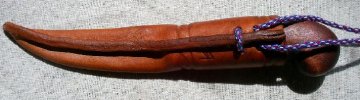

Finished sheath, dyed, sealed, and with suspension cord in place. Like that red white & blue cord? It's Japanese Kumihomo round braid. A simple eight thread braid like that can be learned by most folks in just a few minutes, and you can cut out the necessary jig from a piece of cardboard. It's a skill I love teaching to kids, because they have a lot of fun with it (maybe a future tutorial?).

As you can see by this pic, the wet molded, single seam, sheath is fairly adaptable to a variety of knives, but works best for guardless, reasonably straight bladed knives.
attachment.php
Obviously, the sheath I used in the tutorial is one I quickly knocked out last night for that purpose, but you can get fancy with 'em if you take your time.
A really stout, cool, sheath can be made by carving a wooden inner scabbard, inserting the knife into it, and then molding the leather around the whole rig.
Where will you run into problems? Well, if the blade is wider than the handle, and you mold the leather directly around the knife, guess what ain't coming out of the sheath? In those cases, I simply whittle a wooden shim and tape it to the handle, so it mimics the blade continuing up the knife, until you hit a point where the handle is wider. If that don't make sense, take a close look at a couple of the knives in the above picture, and you'll clearly see what I'm talking about. The sheaths are molded to the handles, but you'll see a little ridge jutting out that makes room for the blade to be withdrawn/inserted.
By tinkering around with shims, and spacers, you can make these sheaths fit dang near anything within reasonable parameters.
