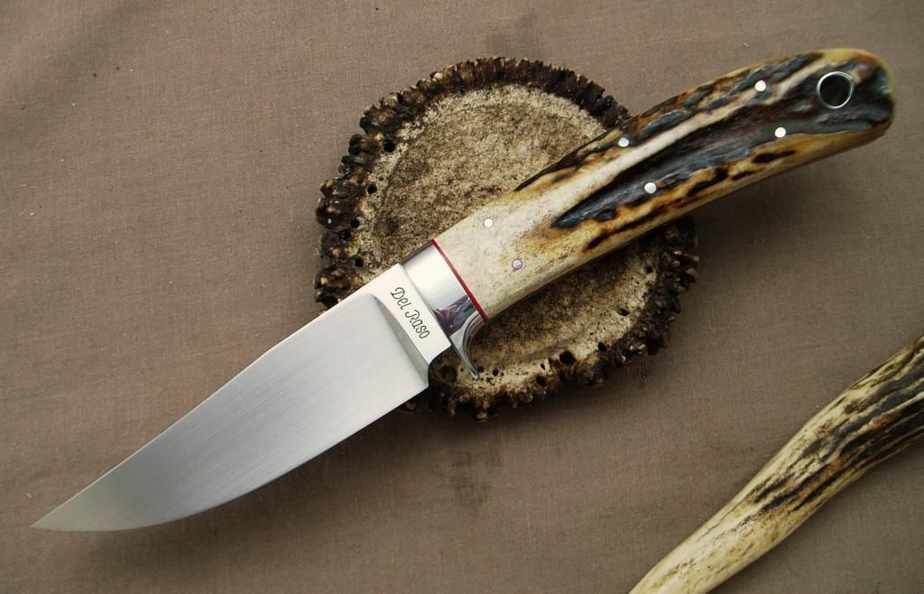

Dave, I really like your full tang knives with antler scales. I get antler that is pale and boring and have tried a few dyes with not much success. Do you stain or dye your antler before/ after sanding? If so what do you use. Any advice would be appreciated. Thanks, Larry Lehman
Best and most traditional colouring medium is potassium permanganate. Mix about 1/2 a teaspoon of the crystals with a pint of water and let the antler round or scales sit in it over night if you want them very dark. Don't freak out when they initially turn purple, they will end up brown. The colour is only on the surface. PP should be freely available at any drugstore.

Larry that piece came from Culpeppers already dyed. All stag antler has been dyed if its got that color everyone likes, regardless of the critter. I use the Potassium too. However when I say it it comes out potassium pomegranite. Anyhoo. I do a lot of elk that I trade for, sourced here locally. Local cowboys find sheds while they are out working and bring em to me. The PP gets it looking like bought sambar. Most of the time the elk I'm getting doesn't have as much color as that piece that Cajun Kamikaze showed. Or its colored on one side and sun bleached on the other. PP is a great disinfectant for this stuff too by the way and was why it was used originally, the cool color was an unintended by product. I get the PP off of Amazon for like $9. Mine is premixed. I keep it in a tuppaware container and just put my pieces in for about 15 minutes or so. Some need a second bath and some don't. I give the scales a light clearcoat finish after they have dried Just gives the down in there a little gloss. If I have to finish a pin to the contour of the stag I will use a 120 grit flap wheel on a Dremel tool. That will marry the pin to the contour pretty quickly and effectively. Then a light buffing to get any scratches out. You gonna have to share Jdm61.
