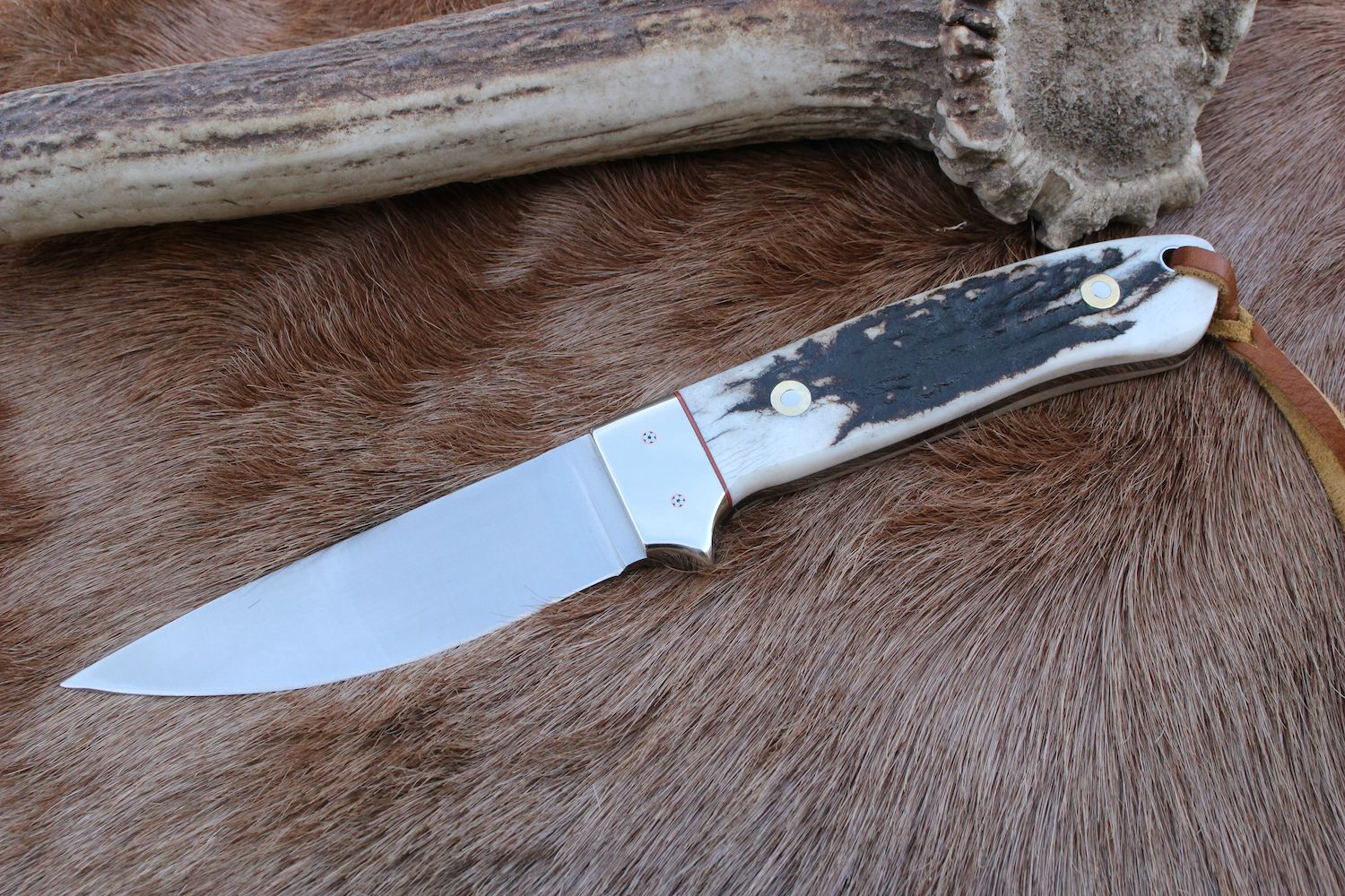

I do a lot of elk. I bandsaw into sections 4 or 5 inches long. I then, using a push stick, slice off one side, which gives me a flat. This flat then makes it very easy to cut off three scales from the rest of it. Deer being smaller it probably is a good idea to glue it to something to stay safe. I then flatten the scales first on my 6x48" with a 36 grit ceramic belt. This belt will remove excess quickly. I finish flattening on the 9" disc with a 60 grit ceramic. Get ya some potassium pomegrate ($9 off of Amazon), mix it up in a sealabe container and soak your scales in there for about a half hour. Using a gloved hand (and other safety items, respirator and goggles during cutting, sanding and dyeing), pull them out and let air dry on a sheet of foil. After they are dried I give them a shot of a clear aersol wood finish, (Deft). This just prevents your hands from getting brown residue on them from the PP later as you handle them. The PP acts not only as a dye but also a disinfectant on the antler. Your scales now look and will finish up pretty darn similar to stag you might buy.

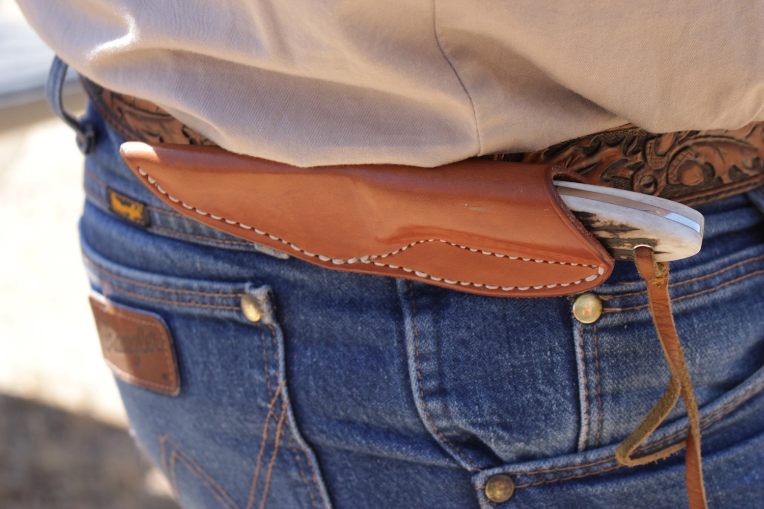

Elk scales processed as described. Another set:
Thanks sir! Ya know once you've done it a couple of times, its more work rolling the bandsaw outside than it is doing the antler.

I belt sand to 330 on the scales then hand sand at 220, 400 then 600. On the buffer fast cut lightly, med cut and then pink scratchless. Coat of car wax and buff off (not only great protection but its great at cleaning up any buffing grunge) using a clean wheel just for wax. They sparkle. The buffer used for the waxing has a plain sisal wheel on the other side. This is used, without any compound, for getting out any grunge that might get down in the textured areas. Brushes it right out.
