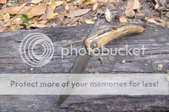

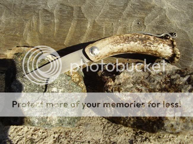

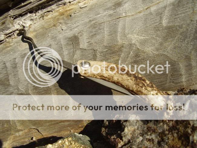

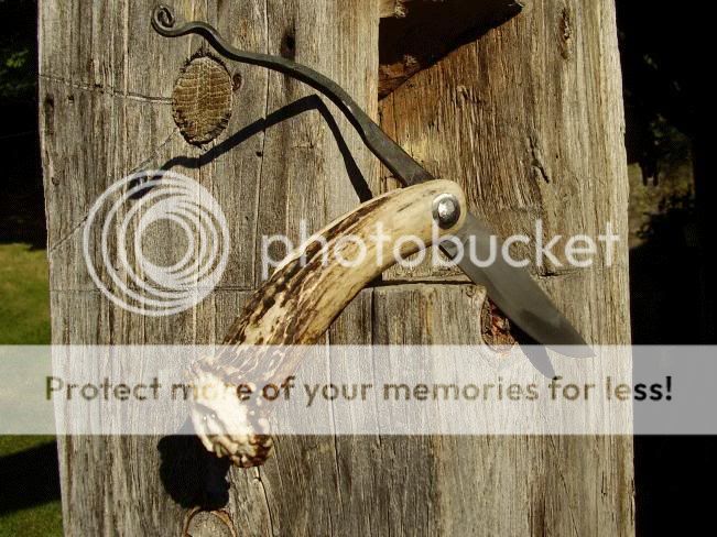

I don't have any plans but here are some pics of one i made a while ago.
There are many diff. kinds this is just how i do mine. I hope these photos help.
I'm working on another one now that is a little different and will post pics when it's done.
Bob

I use a 4 1/2" side grinder with a zipcut disc to cut the groove in mine go slow and make sure it's straight.
