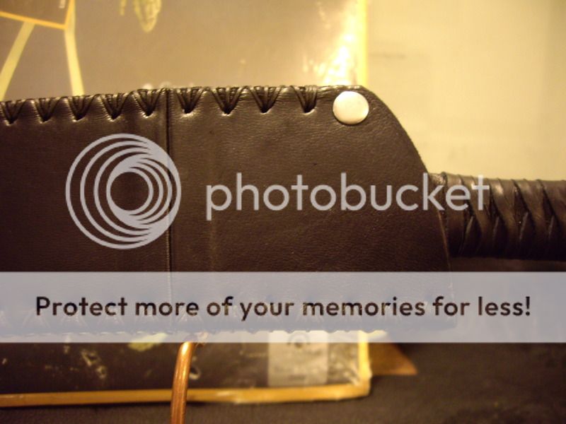

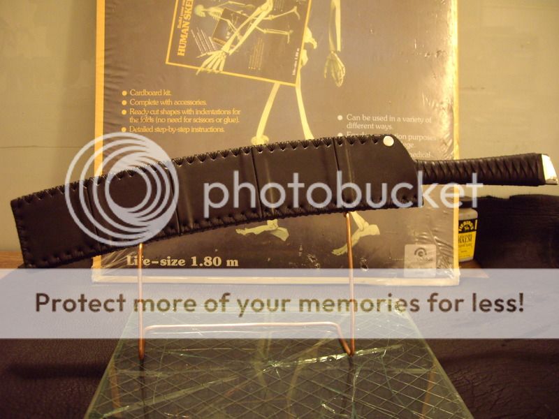

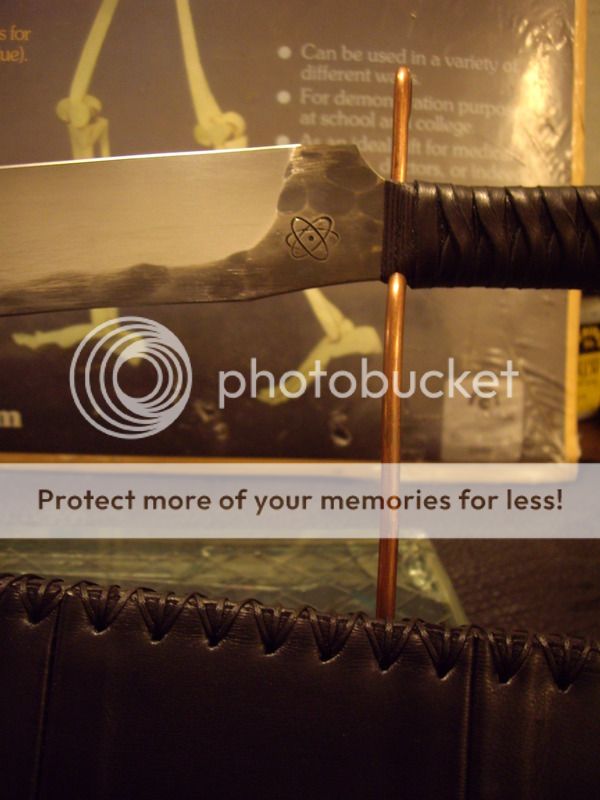

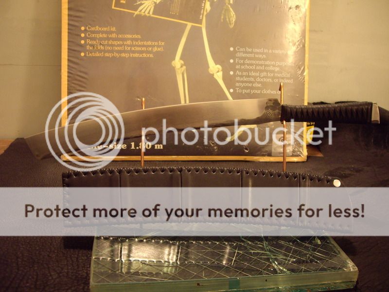

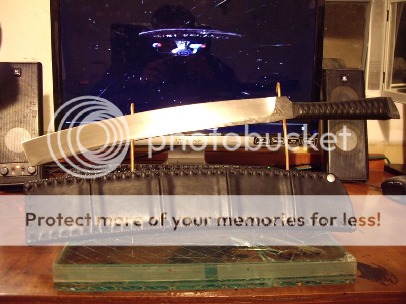

anyways, i love the sheath, awesome with the ribbing and the segments. is the 3 in 1 hole stitching just looks or is it actually holding the sheath together? also where did you use the nylon and where the kevlar thread and do you have a picture of the side of the sheath?

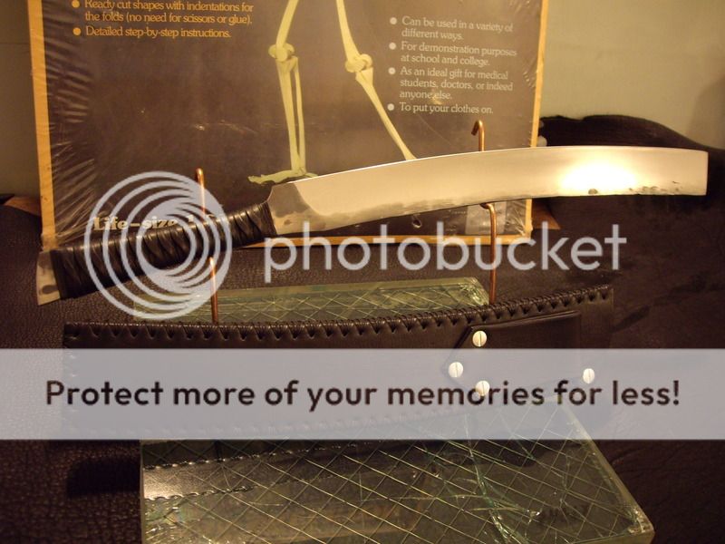

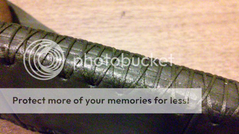

the blade is also really nice, like it a lot. the whole style including the smooth handle wrapping.
also like the tng screen![]()

LeatherMistressØye;14676268 said:I'm glad you like the sheath! I call the triple-stitch the "crow's foot," and it is absolutely functional. It puts tension around the sides, as well as up and down along the edges. I use thin Kevlar thread to sew the panels together on the front, and the waxed, braided nylon cord is what I use for the crow's foot. The nylon has been durable and stood up to a lot of abuse so far, but I'm planning to use something similar in Kevlar, because, well, Kevlar.
Glad you like the blade as well! Believe it or not, it weighs less than the sheath...

awesome, thanks alot! that really looks like something i need to try. did you just use an awl for the stitching holes? sorry, lots of questions, i know, it's just that i always want to learn more.
i think the ridges are an awesome details on the front.
and i sure like the blade it looks really great. i would totally like to have one, but i am more for blades i actually carry and use. (i even sold my spyderco jumpmaster because it was too large) still, it is an awesome piece of work.

never considered that really. everybody seemed to be using stitching irons, awls or awls mounted in drill presses.
still haven't found a decent drill press i like. what kind of drill press are you using?
