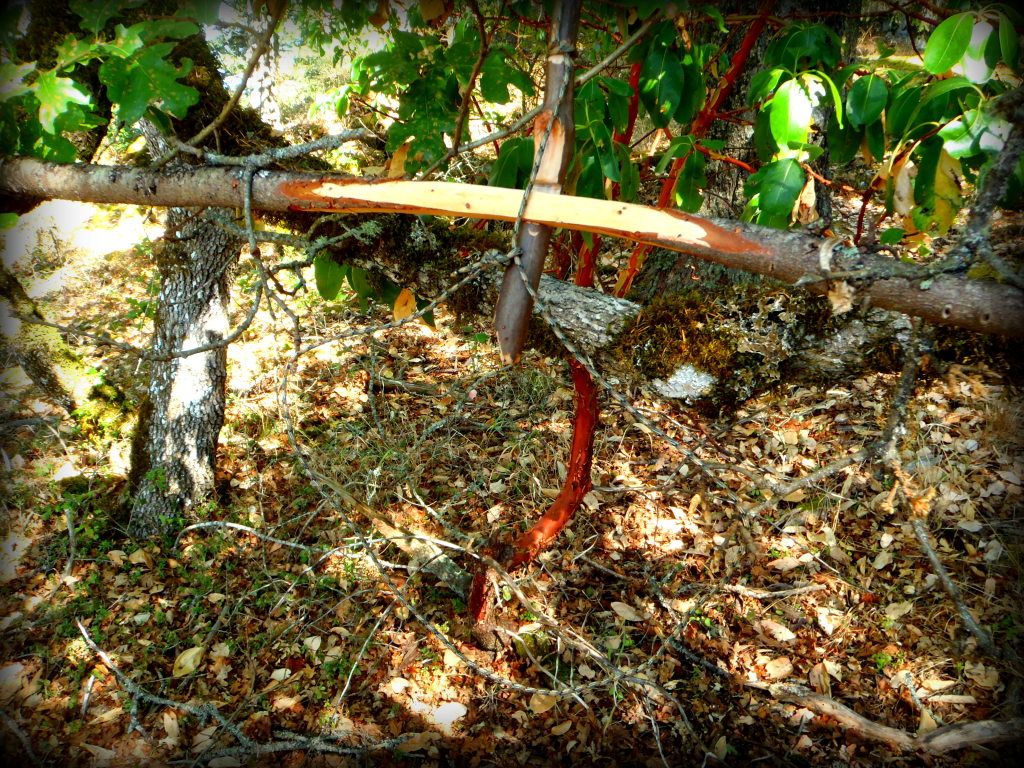

I decided to have a go at a deer trap today, this trap is quite basic in nature and uses a spring snare which traps the deer by the neck. I think this method is better than those which trap the deer by their legs as there would be a good chance of a crazed struggling deer pulling it's leg free.
The hardest part to this trap is finding the right location, it has to be in a deer trail and you have to either have a tree either side with another close by for the spring mechanism or drive two poles into the ground either side. As I was just practicing the trip mechanism today I didn't concern myself too much with the location etc.

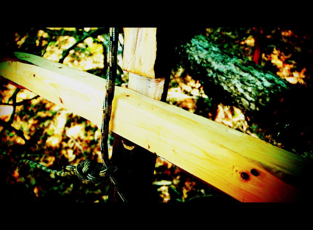

I just used to Cedar roots to lash the cross piece in, this doesn't have to be super strong, just strong enough to hold the trigger stick down !
In a real situation my noose should have been a little lower and larger. You would also add sticks to guide the deer to this point so he can't veer off to the side of the noose.

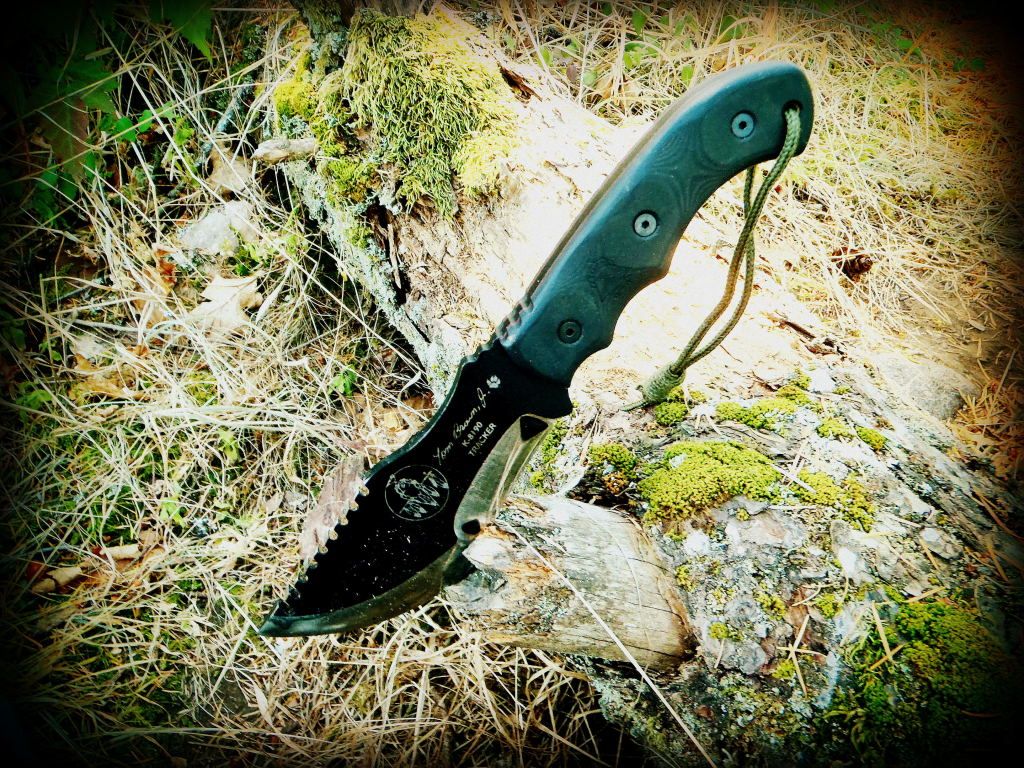

Knife used today ~

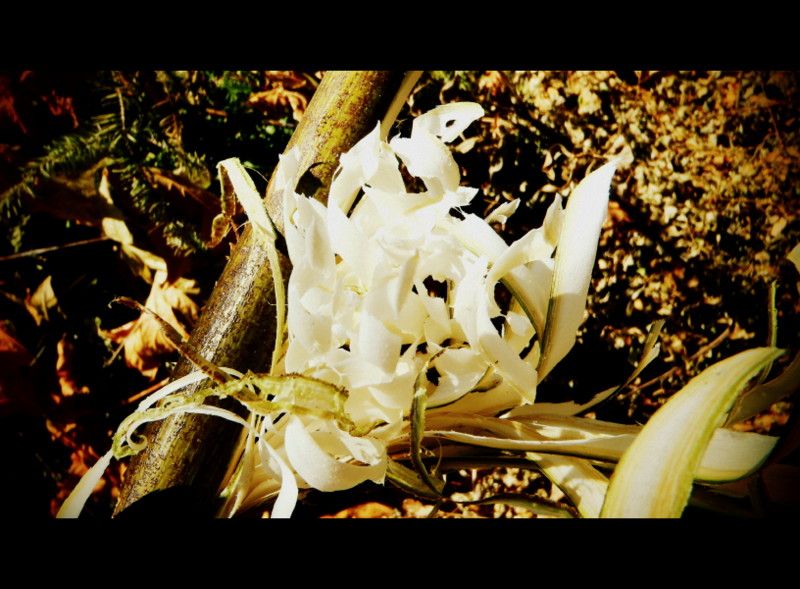

It also makes some decent shavings !
