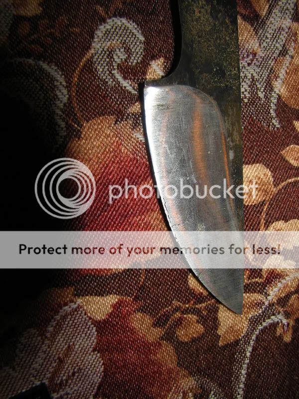

heres the pic
thanks
~chris

Chris,
Looks way to thin on the edge from that angle. When you grind the edge that thin it makes it hard to control the temp in that part of the blade. The result is overheating, distortation and fracture when the blade is quenched.
Leaving a 1/16th plus on the edge will make heating the entire blade more uniform and easier to judge. Heat the spine first working towards the edge. Watch the heat move thru the blade. This will help you learn to judge the temp as it reaches non magnetic. Are you working on the inside of the forge or from the side. Having a set up that allows you to protect the edge and tip of the blade makes this process a lot easier.
Good luck, Fred
