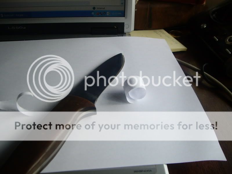

My standard, fillet a piece of photocopy paper.
