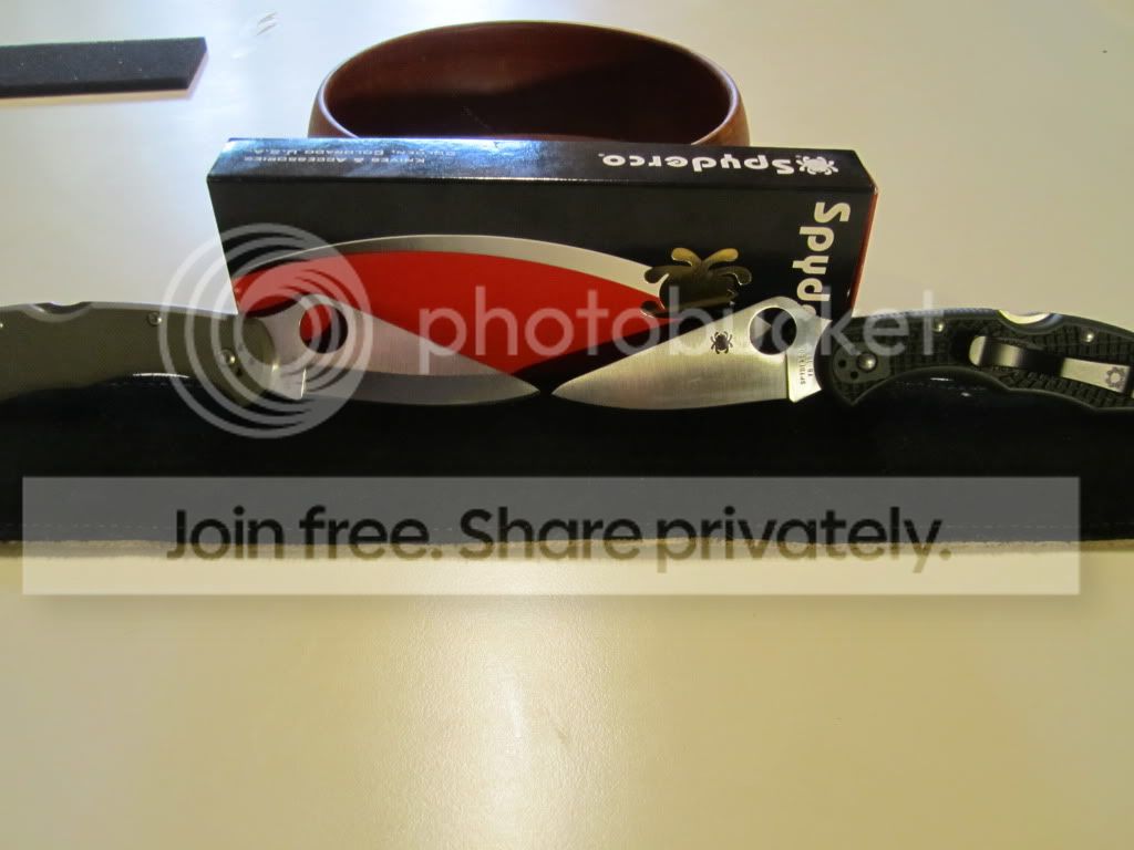

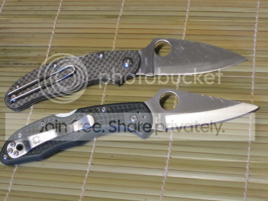

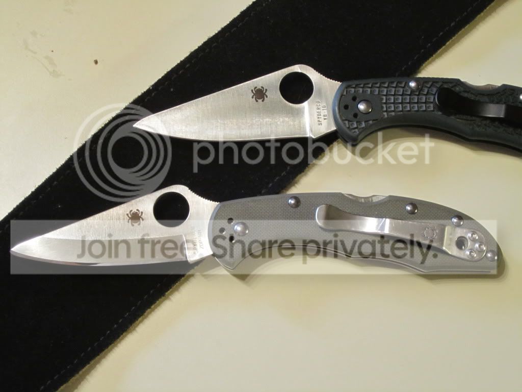

P.S. I know a post isn't a post without something to look at, so here are the two culprits being discussed.

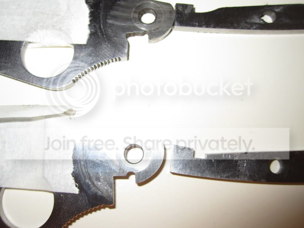

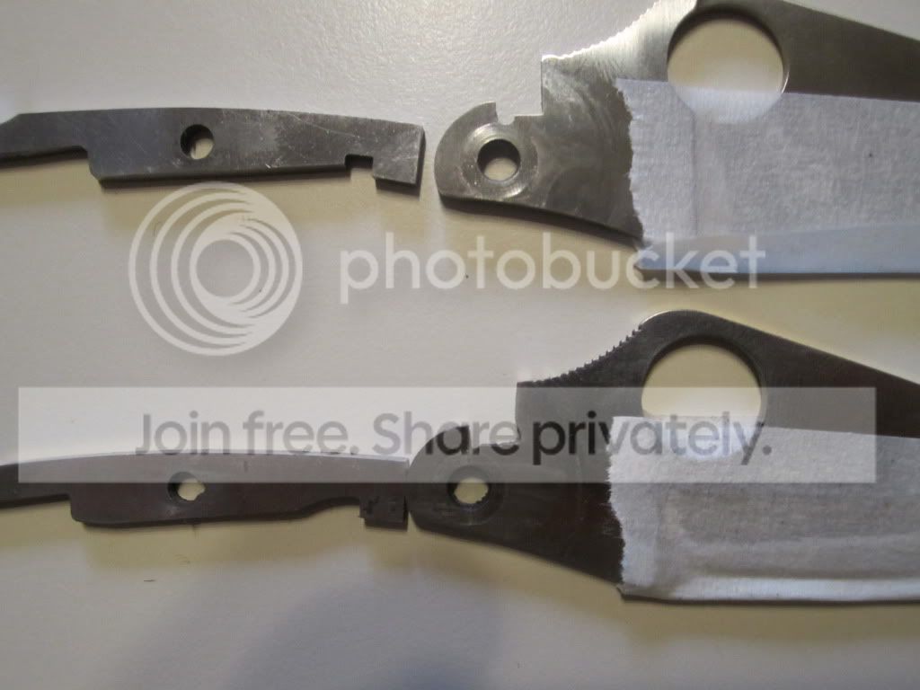

Yea, I'm hoping that corresponding layouts between the two will be close enough to to switch out all three parts. Hopefully :rolleyes: haha. Ill take pictures of both knives open so that any differences could be pointed out. G10 Delica eta ~3days, ill keep everyone posted. Thanks

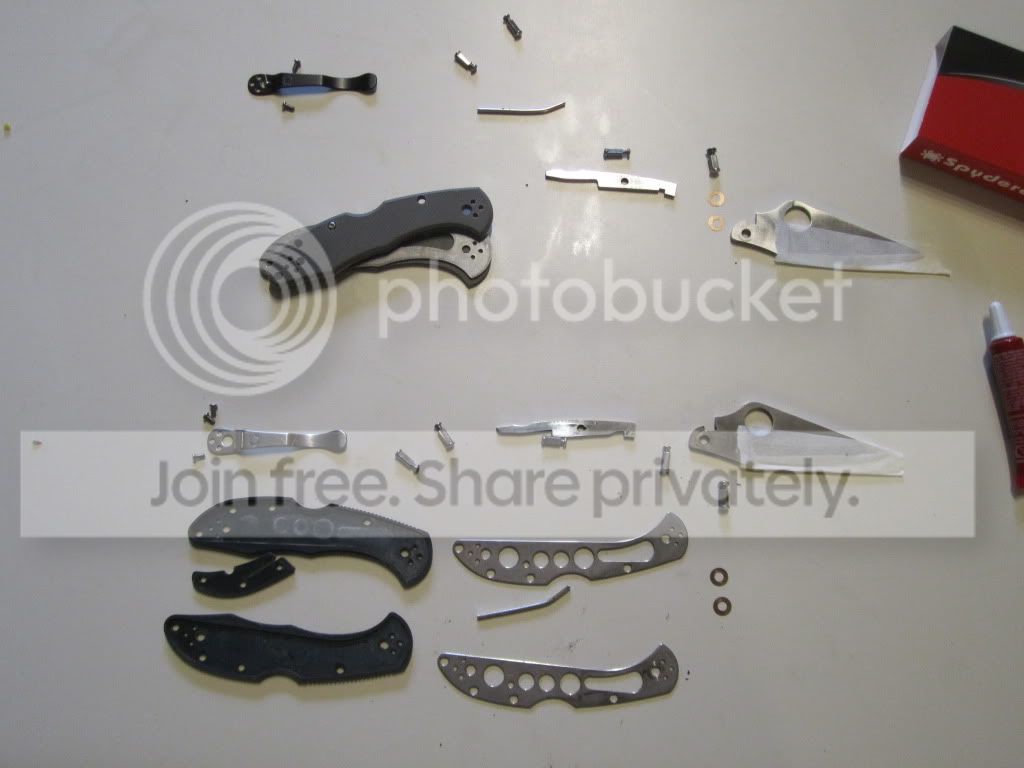

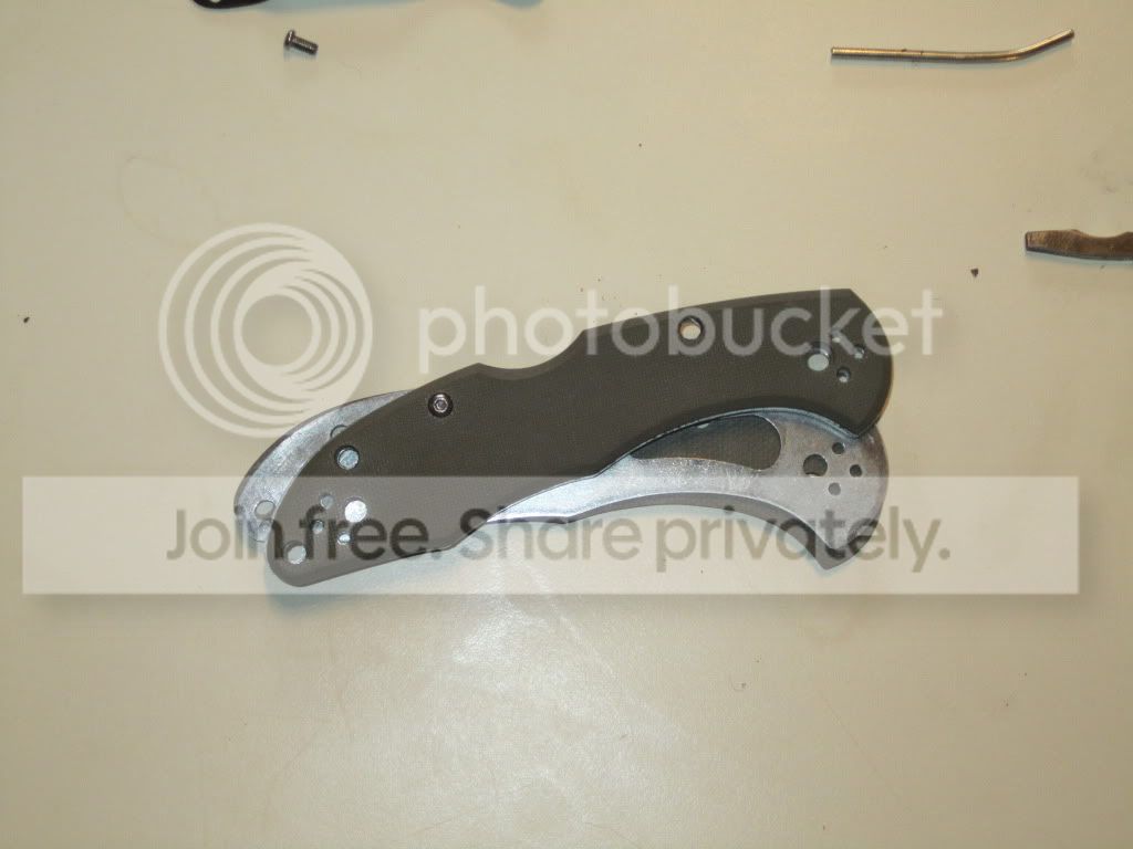

Well after checking USPS tracking just about every hour for 4 days,haha, the new G10 delica finally arrived. Let me just say this knife is solid. I wasn't sure how much of an improvement it would be from the FRN version, but it is substantial. No blade flex or handle flex what so ever. It just feels more solid in your hands over the FRN. To begin the swap I took apart the FRN zdp-189 delica first, and without any problems laid it all out. When I went to take apart the d-bolts in the G10 delica however, the screw behind the lockbar turned out to be completely stuck. I sprayed some PB Blaster on the screw, let sit 30 min, still would not budge. Working with a T-6 screw tip does not allow for much torque either, if too much pressure was applied the tip of the driver would mar/ strip out. After taking a dremel to the T6 driver head 3 times (to grind down to a good tip again) I had to give up. I removed the 4 other d-bolts and luckily I had enough play with the liners to still move the back spacer around a bit. After taking apart both knives only some small differences could be pointed out. Of course the liners, The G10s being identical in design except with an extra ~1/8" of metal around the outside. The two other differences go hand in hand but, it appeared the blade lock and lockbar designs differed slightly between the two models. Putting both knives back together went fairly smooth and I was able to swap out all 3 parts between them (blade, lockbar, spring). After putting them back together I hit the screws with some loc-tite blue and tightened everything down.To finish it off I cleaned them up, then polished them for the photo shoot. :D As an aside, I was quite surprised at how much lighter the ffg blade felt compared to the saber ground blade. It really feels quite light in the frn handle, and the saber ground definitely feels better mated in the g10. All in all very happy with the swap, and if it wasnt for that one d bolt everything would have went extremely smooth. If you're on the fence like I was, do it, you wont be disappointed. If anyone is still looking to pick up G10 delicas let me know and Ill send you the link to the store I got them from. Cost me 140$ shipped, from Canada to Maui :). I took some before, some during, and some after pictures, enjoy.

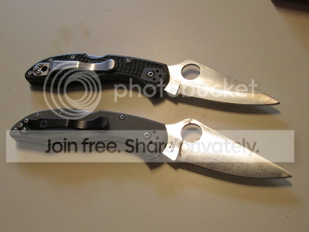

Bottom is SG zdp 189 blade, top is the ffg vg 10 blade

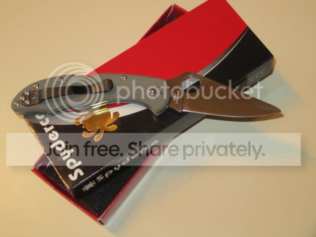

Swap is complete, polished up the zdp blade

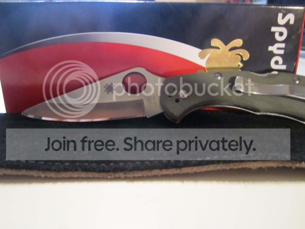

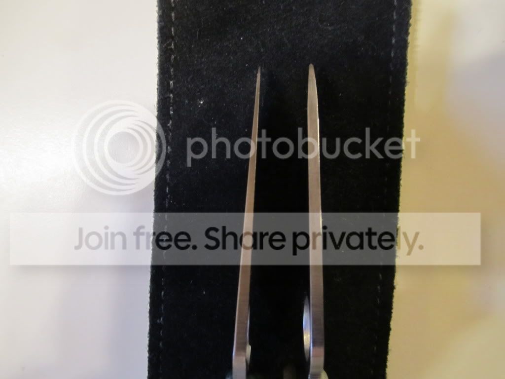

Blade width differences
