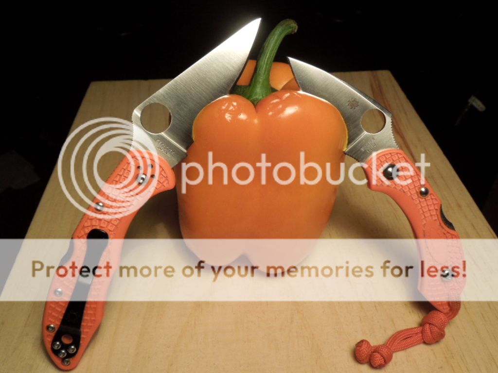

Photo: by me, not 'gleaned' from the net.
