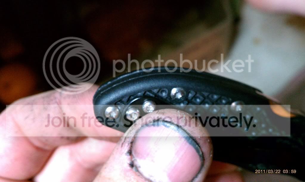

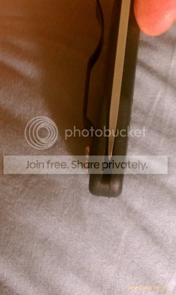

Will take some and post, will have to get a photobucket thing since I haven't signed up for Gold membership yet.

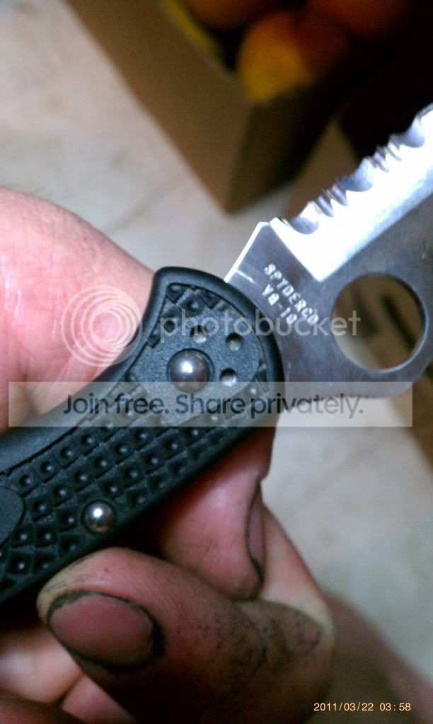

You can't really see the spot in the spyderhole because of the lighting but it's in the reflection.

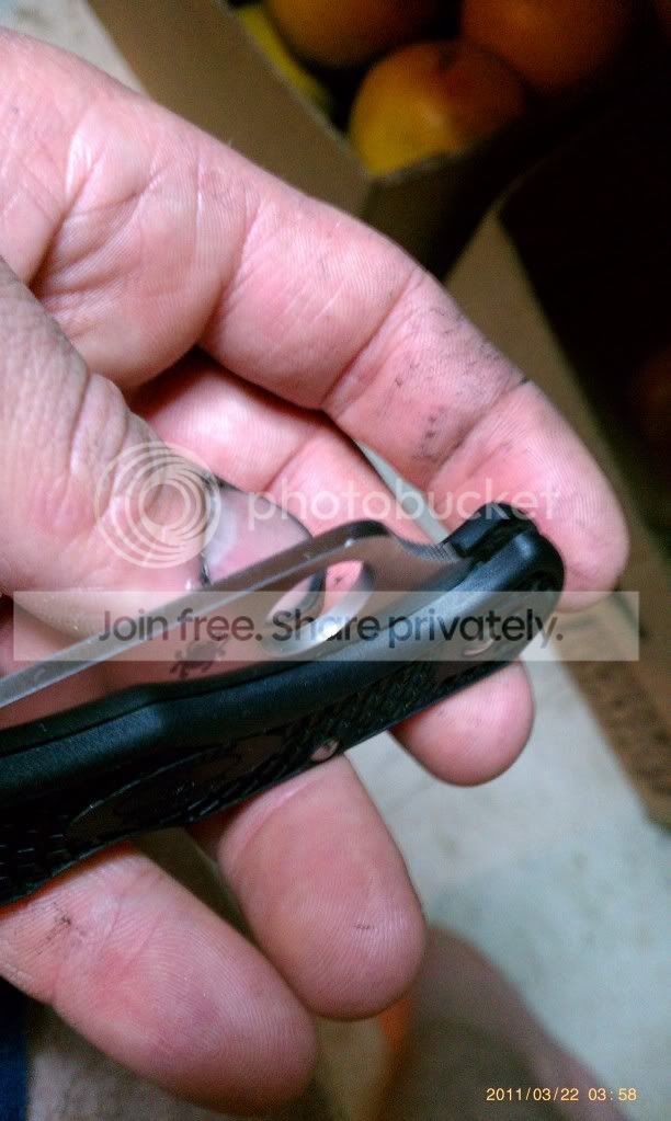

Sorta can't really tell too good from the pic. To me it almost looks like the grind isn't even the same on both sides. Forgive the quality of pics. Having to take them on my phone.
I've never seen scratches on the tang on delica/endura before. I expect it on knives like Caly3 or metal handled folders but they're made differently. The little leftover slivers on the FRN handles are no big deal, I ignore them but I guess you can try and cut them off.
The Spydie holes are often like that due to the laser cutting. I have a number of Japan-made knives with the same residue. The US made ones come well finished but I guess the makers in Japan don't go that far. I've fixed them by wrapping sandpaper around a pen and grinding them off if it interferes with my thumb.
One thing you can try is to loosen all the screws, center the blade by wedging something like folded paper between the liner and blade and re-tighten everything. You may fix centering and rubbing issues. Adding a little blue loctite can prevent future headaches from lost screws.
