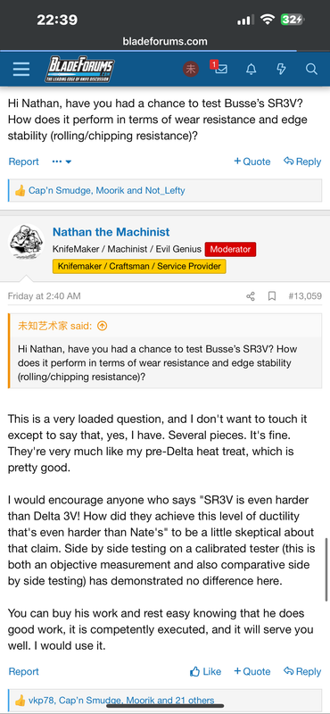

If anyone actually has the setup to do a proper side-by-side, I’d really like to see Delta 3V vs SR3V tested under identical conditions — same primary grind (same V-bevel geometry), same edge angle, same sharpening.
For edge retention, a coarse rope cut test would be straightforward. For edge stability (impact resistance / deformation), using identical nails or bolts would make sense.
For the nail test, clamping the blade in a vise and striking with a hammer would help eliminate lateral variables.
Run both steels through both tests, side by side. That would be genuinely interesting — I think a lot of people would want to see how it actually plays out.
