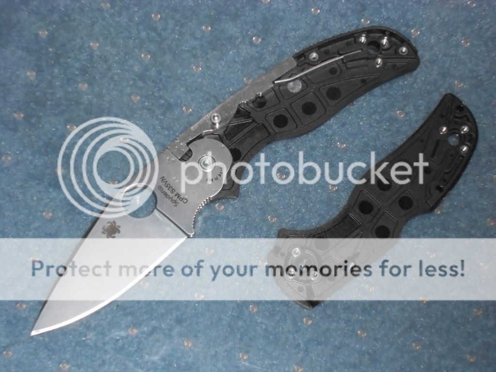

Did anyone demantled the Native5 S35VN?I want to know if there any copper space in?
I come from Taiwan, but I can't find any information in here, help me please..:p

What a coincidence; I just decided to open up my Native 5 FRN today and snap a pic.
The construction is very elegant for an FRN knife - probably the best I've seen. I imagine the ribbing is there to give it rigidity (and it is extremely rigid; it resists flex very well when you try to squeeze the two scales together).
I also like how one scale fits into the other via the backspacer. It makes for very clean disassembly, and you don't have to do any tricks to put it back together again (like with the Delica and its lockbar - the backspacer's nipple misses the liner if you have the blade and the lockbar in).
As for washers: there are none. The action certainly isn't the smoothest ever.
It's a very good knife, though, especially for the money. If you're looking for something more heavy-duty, consider the G10 or CF versions. The fit and finish are much better, too.
