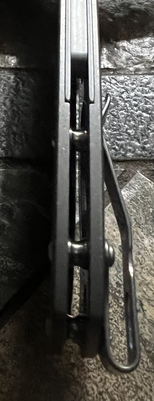

The other issue with the hardware is that the six scale screws are all the same length. That means that it’s a pain to get them to thread into pocket clip. It can be done on the stock clip, but I had to use the original longer screws on a Lynch clip.

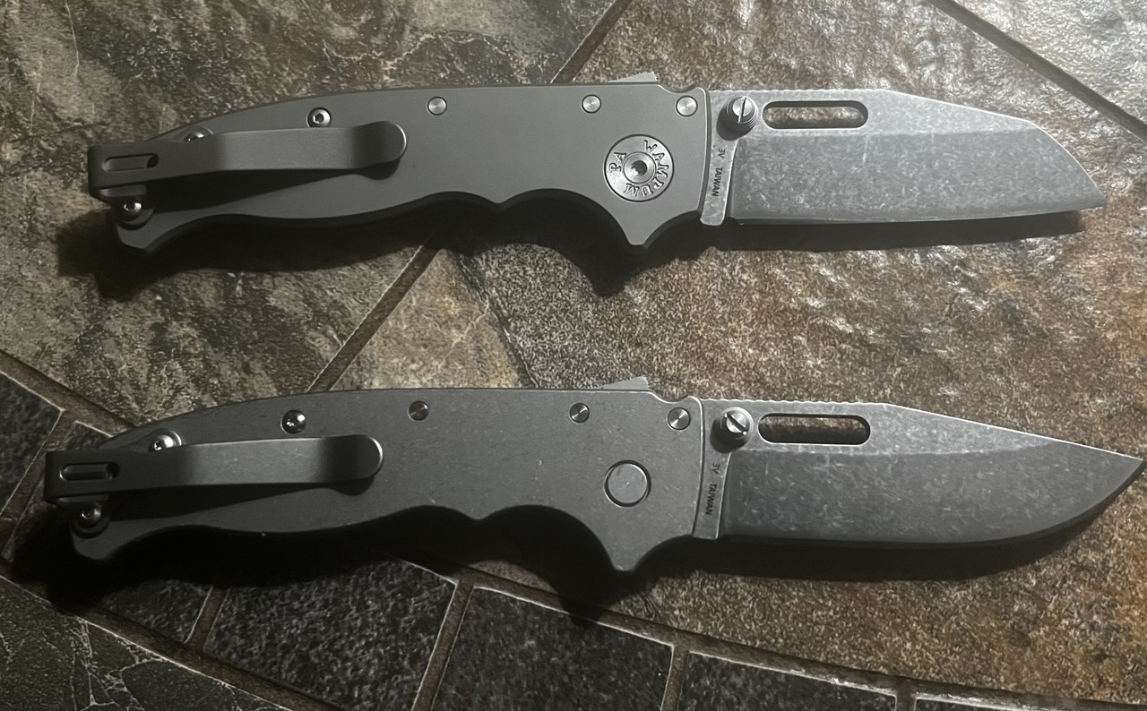

Demko on top:

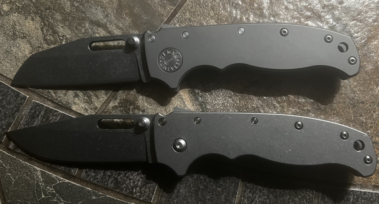

Berkshire:
Demko:
