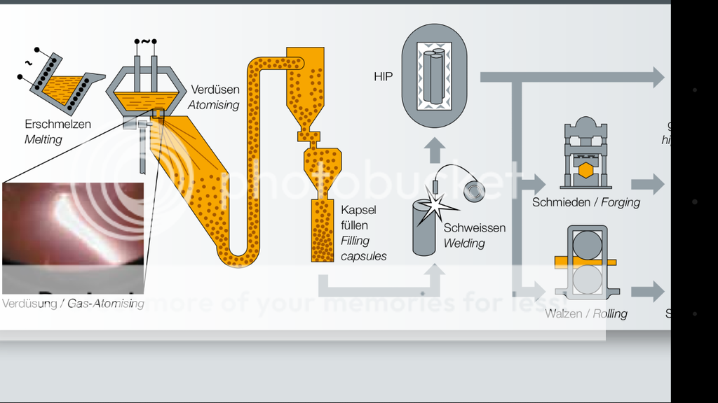

Here's a reference chart from bohler Metals to the PM process.
It's the powder metal process that allows more alloying then physically possible with normal ingot steels.
Each droplet becomes a "micro ingot" that allows for the even distribution of alloys and carbides.
This means we get 3% carbon, 20% chromium and 1.4 molybdenum
There is also trace amounts of a few other elements but these are the heart of this steel.

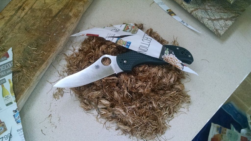

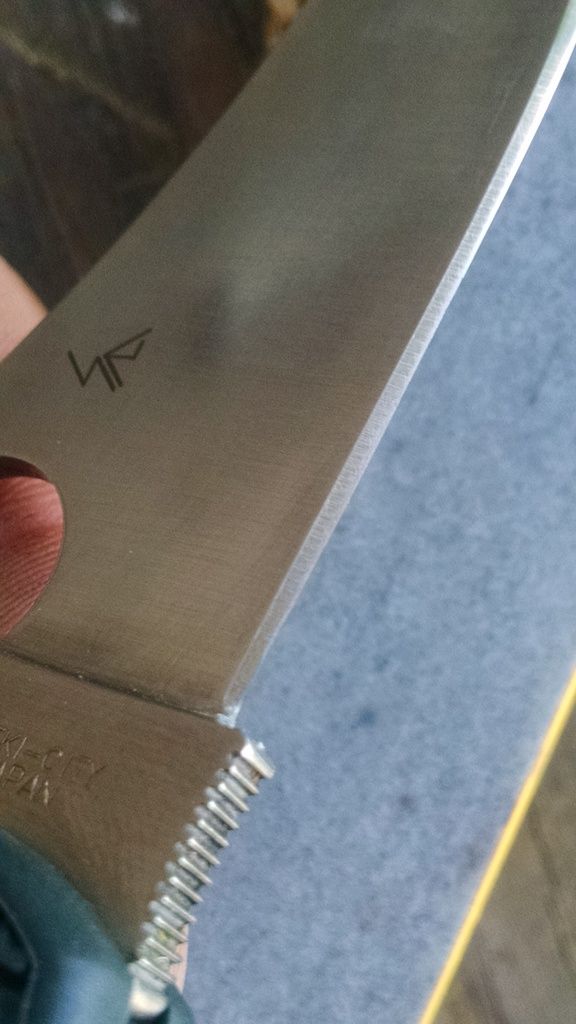

I've been EDC ing this blade for a few weeks.
Mostly utility cutting. Food and packages some cordage.
Hahaha I even dropped it on the tip on asphalt! Yikes
It didn't shatter into a million pieces either just a dentin the tip that will come out naturally in a few months of using and sharpening
I've also used it to clear some bramble Bushes and left the green plant gunk on the blade. Slight discolored the blade but wiped off with no patina or rust. Unlike my Gayle Bradley in M4 that would patina instantly if not wiped in seconds.
Sharpened the edge freehand on a DC4 while I was at work then I hit it on a 3k and 8k a few days before testing.
No chips or dings, sharpened at the 15dps but the microbevel is still present just microconvexed it. The micro is under 20 fully apexed and polished from edge trailing passes.
If I wanted HHT 4 I'd have to do a 15dps zero with no micro.
But that's for another update and will be explained later if confusing.

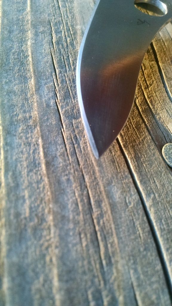

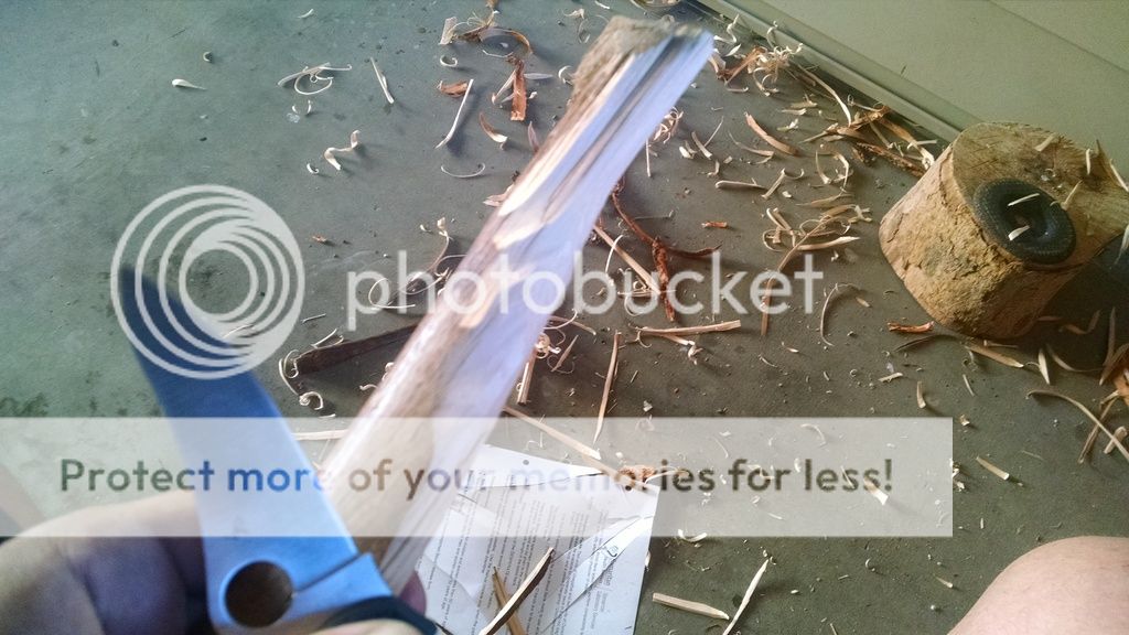

Here's our first subject a finger thick piece of pinewood with Bark.
I didn't cut it gingerly. I went ape on that wood.
Shredded it.
Time to check the edge.
Nothing, no damage, just debris
Huh? last time I had damage from doing something less forceful on pine. Must have been some burning on the factory edge.

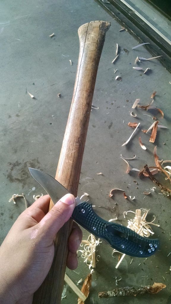

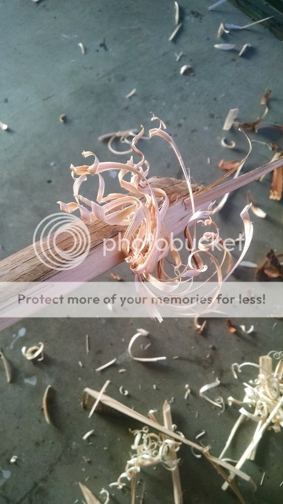

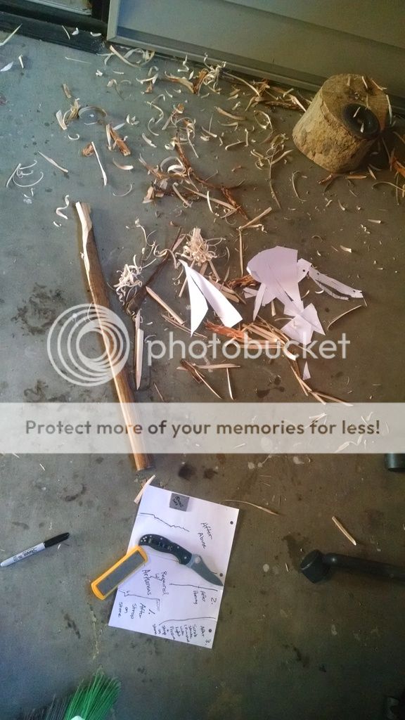

No mercy. It's time for carving this old weathered hickory axe handle.
Brutal stuff. Very hard. Not easy to carve.
Again, full strength cuts I'm not holding back
Still sharp enough for some hickory feathers
Shredded the handle, used full strength and speed.
Hahaha OMG the blade feels hot from the cutting!
Was cutting big chunks like this every cut.
Made some cuts on paper a few snags. Most have damage but not visible to the eye and still cuts good.
Still shaving sharp doesn't need to scrape catch's hair on skin and pops em
Again no damage.

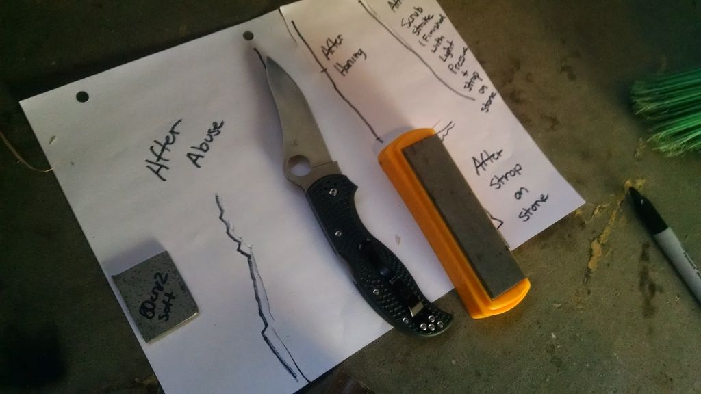

Alright time to punish ZDP189 to the breaking point.
I have to know what the limits are.
Time to deburrs and shave a piece of steel!:eek:
Spheroidized annealed 80crv2 to be exact.
Cut off all the Burrs, then I tried to "feather" steel.
Not quite feathersticking. I'm not well practiced at making metal ones :D
I then tried to lightly baton the steel with some light taps from the axe handle.
Left a mark.

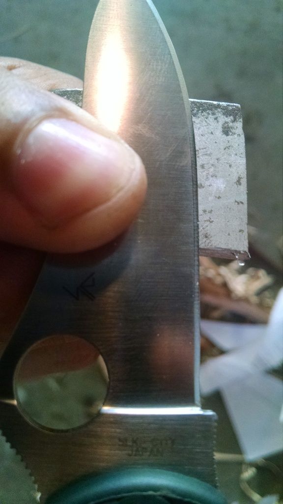

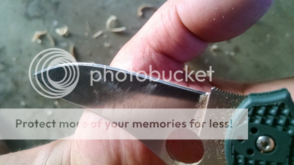

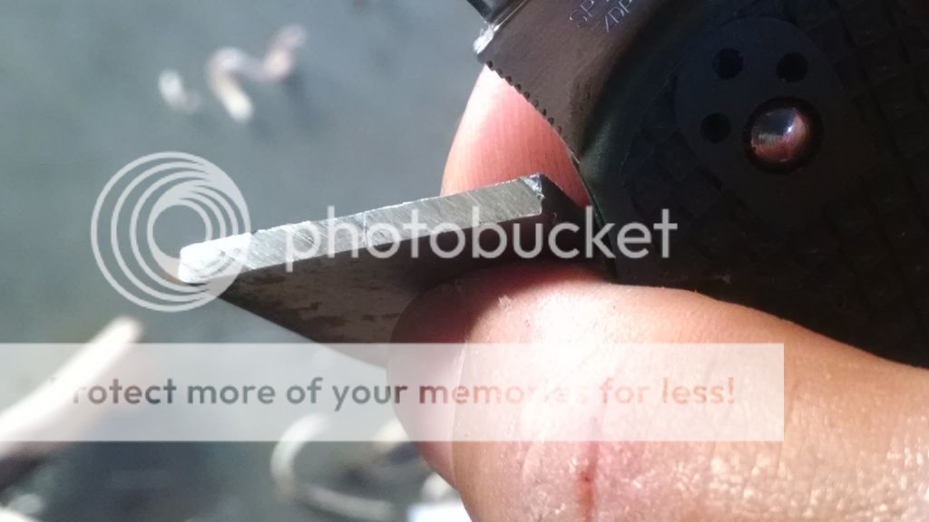

Wow, actually not that bad.
Visable damage with a larger more noticeable chip but very small considering my expections and the abusive cutting.
From the batoning, deforming near the heel.
Here's a better close up of the damage

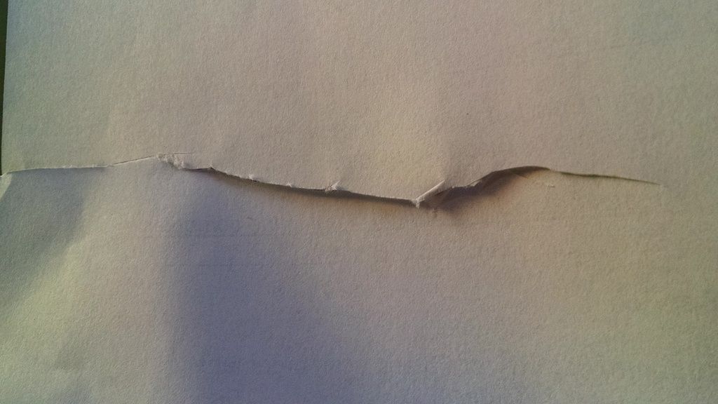

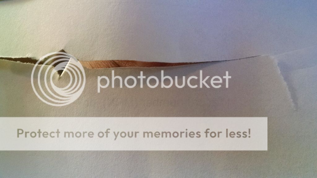

Here's how well is cuts.
Made a raggedy cut in paper but still did it.

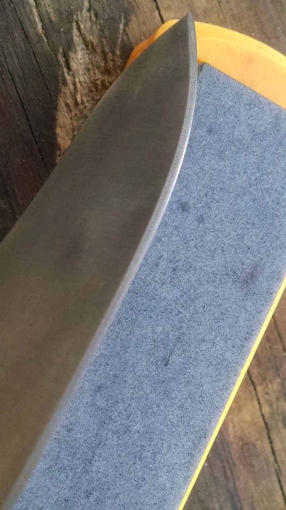

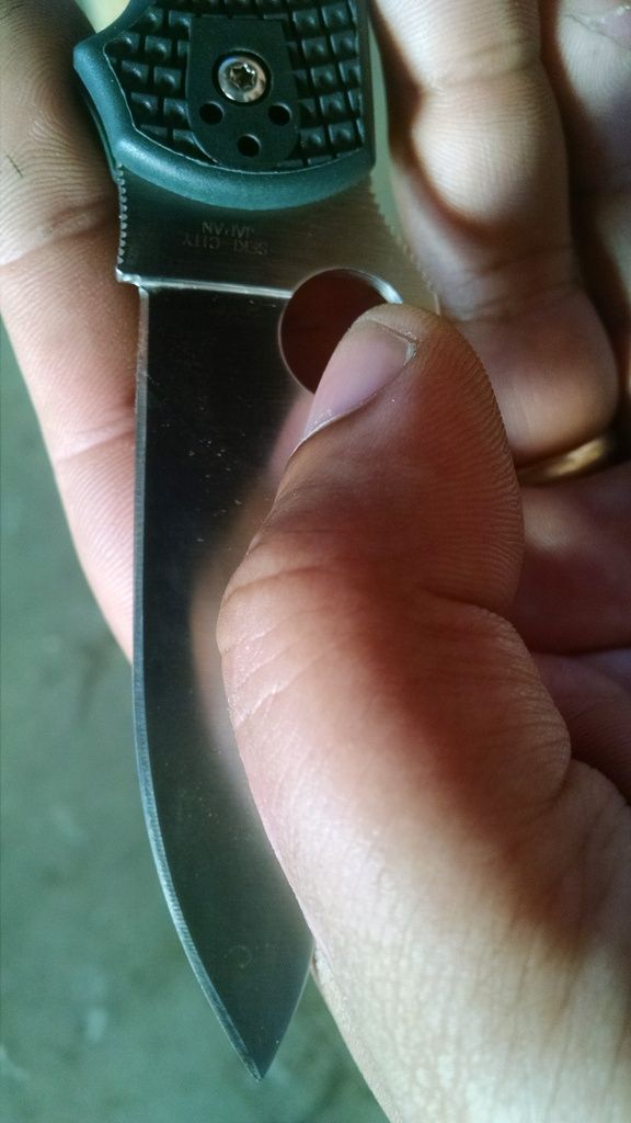

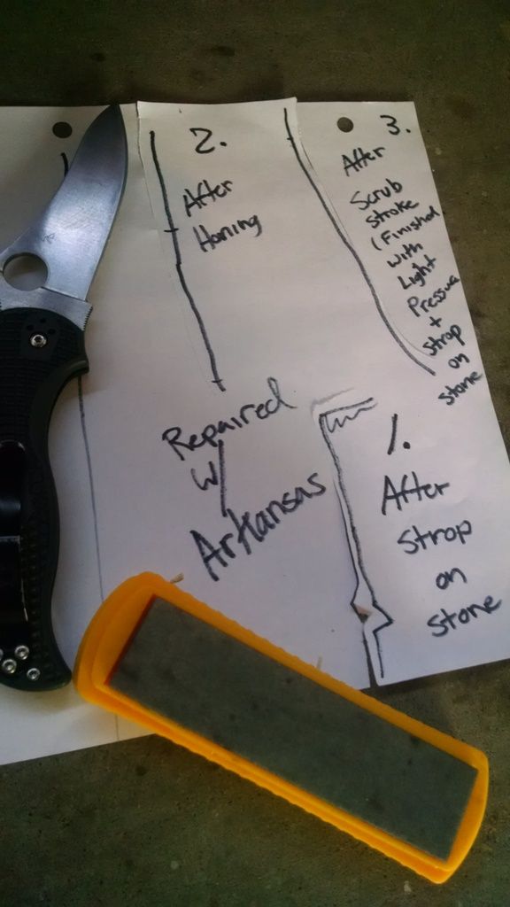

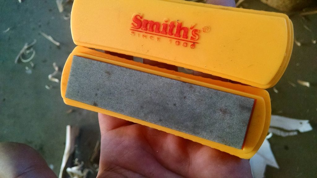

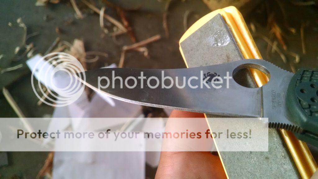

Hahaha time for sharpening blasphemy.
I'm going to use this cheapo soft Arkansas stone to restore the edge.
Whaaa?!
:eek:
Here is the bevel after 20-30 alternating passes on the stone.
Most of the damage seems to have been burnished back in place.
Of course the single chip remains. Very small though, can you see it?

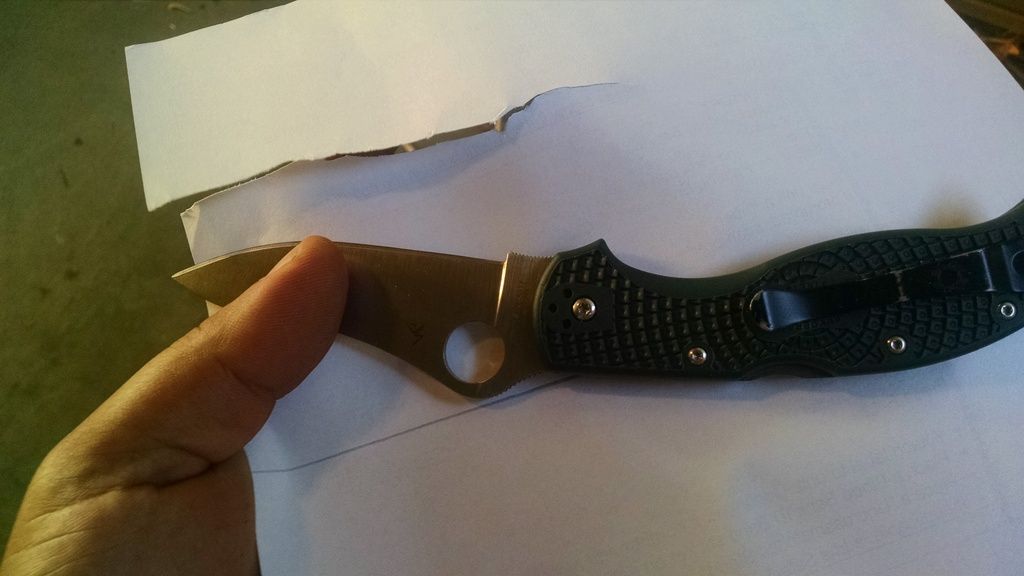

Here's the cutting.
Gross.
Let's do it again, but this time, I increased pressure with edge leading strokes each side 20-30 times. I reduce pressure with each stroke Frome 3lbs to the weight of the knife.
Cut cleaner but still some raw damage tearing the paper.
Back to the stone!
This time a rapid Japanese style scrubbing stroke
I didn't make a burr, I just did it until the damage was realigned I then finished with stroping passes on the stone.
The edge looks good feels sharp.

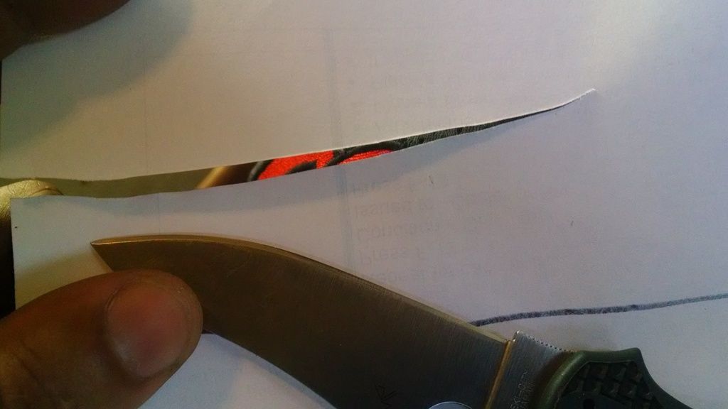

Time to test.
Acceptable
This edge looks good too
Haha cool shaves again too

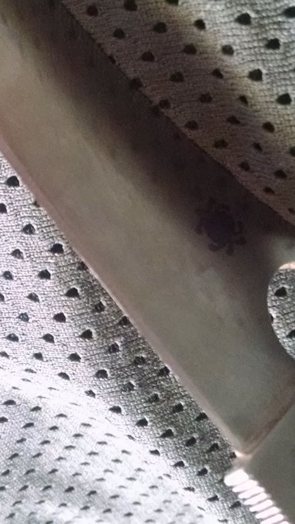

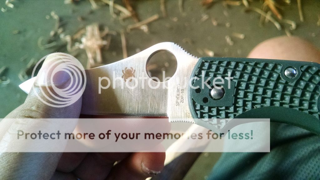

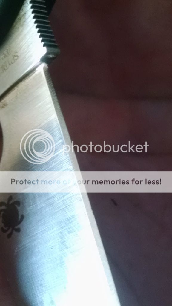

Conclusion on testing.
Aftermath
Close up on edge
Well, I guess it's not that chippy with the factory edge sharpened and used on proper cutting mediums
Now I know. Cool
Also, you can keep it sharp with crap abrasives. It's all in the hands that craft the edge.
