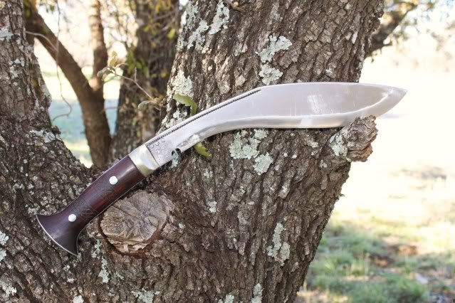

Here's mine, 18.5" overall length and 29 ounces, made by Tirtha:

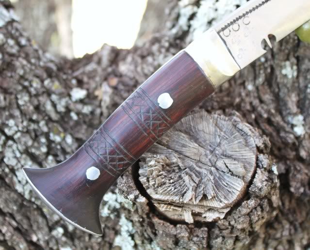

The Deradune is obviously a full tang khukuri with no ring at the handle.
The pommel has two small bumps where it was peened onto the tang.

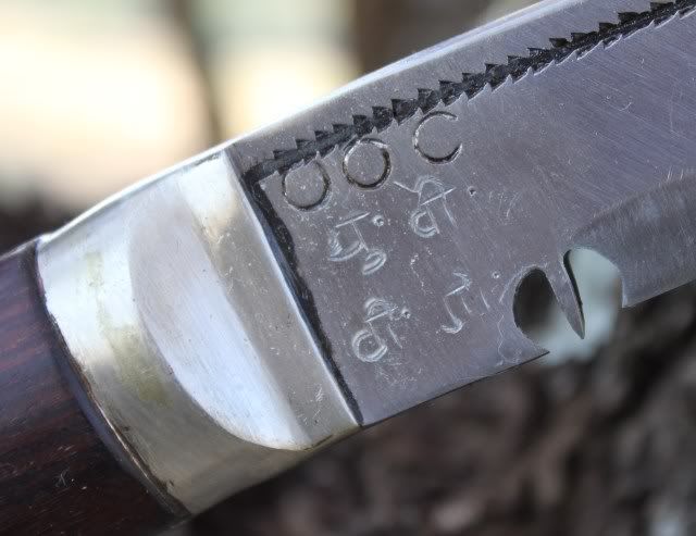

Interesting detail at the groove:
I won't get into whether or not this is a hybrid between the ASTK and the M43. :)

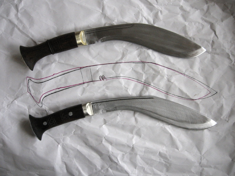

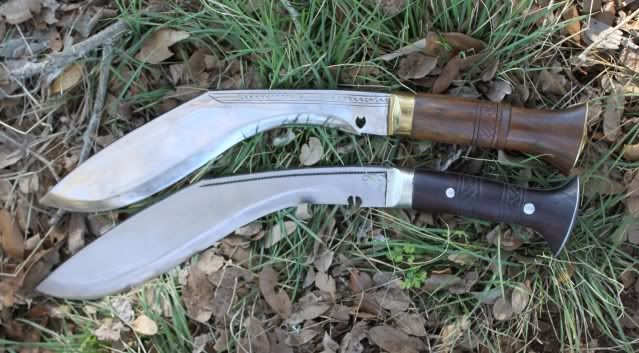

I don't have either of those two models to compare with, but I do have a similar sized Ganga Ram Special
to compare and contrast. Here they are, with specs below:
Specs: Deradune / GRS
OAL: 18.5" / 18"
Weight: 29 oz / 28 oz
Blade length: 12.75" / 12"
Tang: Chiruwa / Stick
Blade width
at bolster: 3/8" / 3/8"
Blade height
at bolster: 1-5/16" / 1-7/16"
Blade width at
sweet spot: 5/16" / 11/32"
Blade height at
sweet spot: 2-1/4" / 2-3/8"
Bevel at
sweet spot: 20 deg / 20 deg
Bevel at
recurve: 25 deg / 25 deg
Grip circumf.
at bolster: 4" / 4.5"
Balance point
from bolster: 3.25" / 3.5"
Pommel
height: 2-3/4" / 2-11/16"
Pommel width: 1.5" / 1.5"
The outlines of the the two blades were overlaid on the paper in the photo, lining up the tops of the blades in
front of the bolsters. While the Deradune's handle drops lower than the GRS, the cutting edges run remarkably
parallel, especially around the area of the sweet spot. The tip of the GRS is obviously shorter and not as pointy.

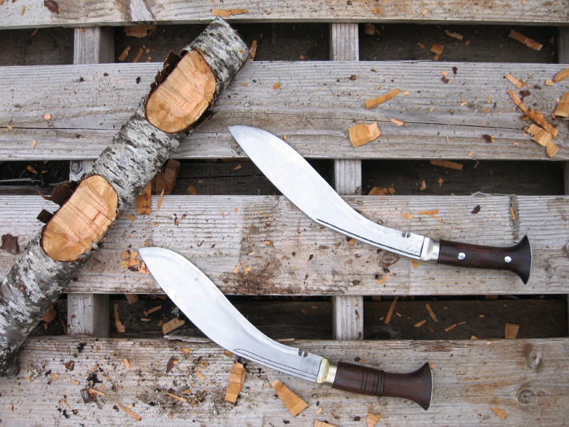

Chopping comparison:
I was curious about how these similarly-sized yet differently-designed khukuris would compare at chopping. I got a
dried branch of cherry wood to chop up, and made the same number of chops with each khukuri, trying to use equal
force. (I had first put a shaving-sharp convex edge on both blades.)
Almost identical results, with the GRS going slightly deeper.
Repeating the test gave similar results:
I kept chopping for a while to get a better idea of how they compare. Here's literally all that was left of the branch:
Results from this very limited trial:

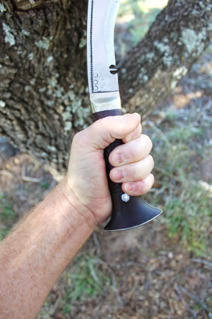

The full-tang Deradune feels livelier and has noticeably better balance (no big surprise); the GRS feels a little
"clunky" in comparison. The GRS seemed to hit more solidly, like an axe, while the Deradune seemed to hit more
quickly, giving pretty close results. The crosshatched grooves on the handle of the Deradune seemed to be an adequate
substitute for the ring on the GRS handle, with no slipping or discomfort noticed. The GRS seems to have an
advantage in chopping ability, while the Deradune is probably a better all-around khukuri (more nimble, pointier,
and probably a better drawknife with its extended recurve).
Concluding remarks:
Judging by the DOTD photo, I expected the Deradune's handle to be a good fit for my 2XL hand size, similar to my
GRS. I was disappointed that the grip circumference was smaller than expected, and I was ready to see if anyone I
knew wanted to buy it from me at my cost. However, after using it briefly today, I am impressed by its performance
and now I want to keep it.

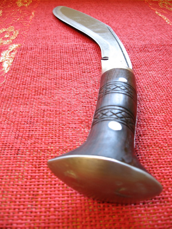

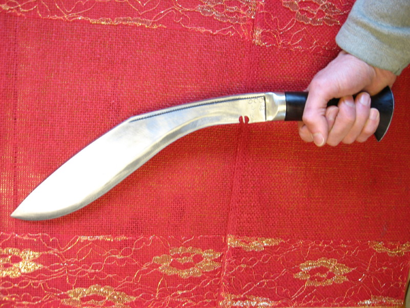

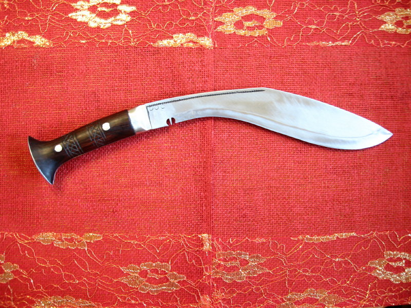

Pics of the Deradune -

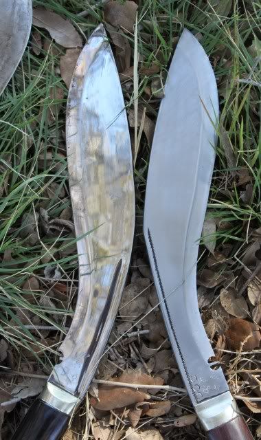

I am not normally a fan of chiruwa handles, much preferring hidden tang khuks. One of the reasons I don't like full tang handles is because they are often too large (thick) for my hands. One of my few full-tang khuks is an M43.
My M43 has a blade almost exactly the same length as Steve's Deradune, but the handle of the M43 is significantly shorter and thicker.
I like the handle of the Deradune much better, as it is smaller in diameter, longer, and has a much more pronounced flare to the butt.
The blades of these two khuks differ somewhat also.
The M43 blade has a continuous curve from the handle to the tip, whereas the Deradune has a definite "shoulder" on the spine.
Most of the curve to the Deradune blade comes from the butt to the "shoulder" on the spine, whereas the curve of the M43 is more or less continuous from butt to tip. I much preferred the feel and shape and handle of the Deradune to MY M43.

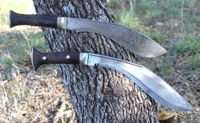

I next compared the Deradune to what I believe to be a WWII which I picked up from HI several years ago.
The main differences I found between my large WWII and the Deradune are 1) the straightness of the WWII between the butt and the "shoulder", and 2) the handles. While the WWII does have some curve (not nearly as straight as the Pen), the Deradune has quite a bit more curvature. From the "shoulder" to the tip, the two knives are very similar.
The handle of the WWII is a bit thicker, and on this knife, not as comfortable as that of the Deradune.
