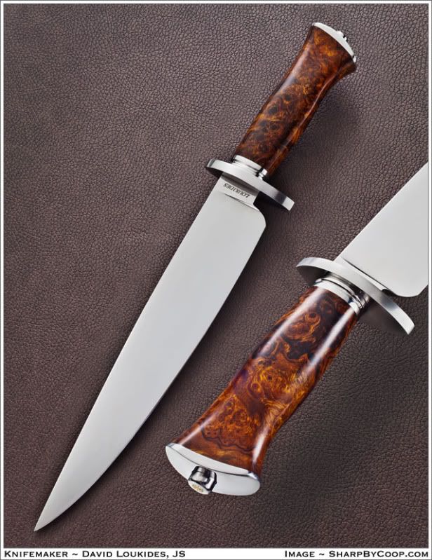

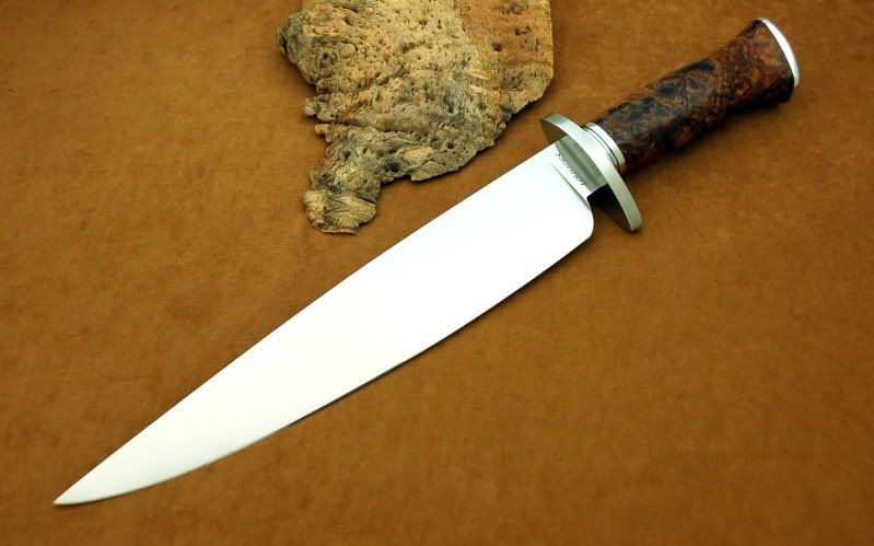

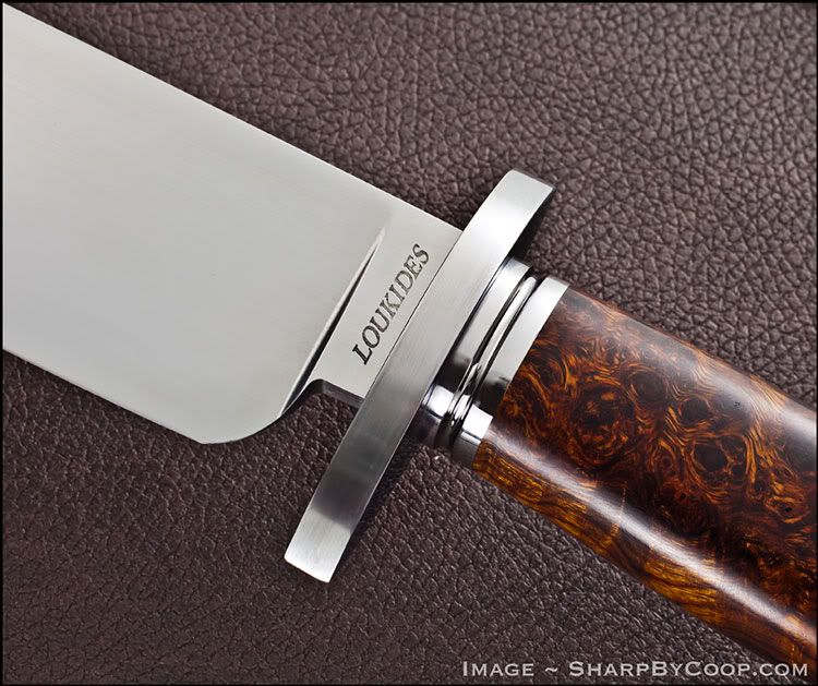

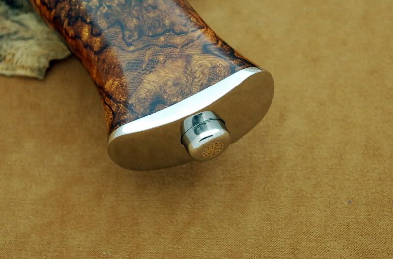

A customer wanted me to remake one of my 5 JS test knives for him.
Spec's,
Blade is forged to shape 5160.
Differentially Heat treated Blade.
Blade length 11.5"
Over all length 17."
Max blade height 2."
Blade thickness at recosso .225"
Guard, spacer and Butt plate 416 stainless.
Pummel is fixed on and has a mosaic pin inset.
A+++ Desert Ironwood Burl handle.
Questions or Comments Welcomed!!!
