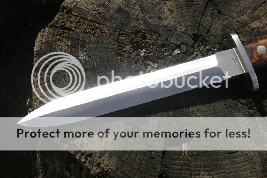

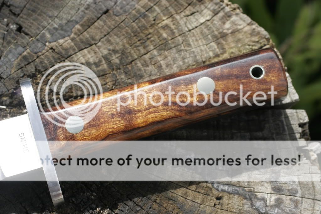

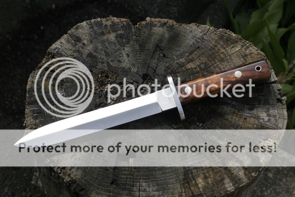

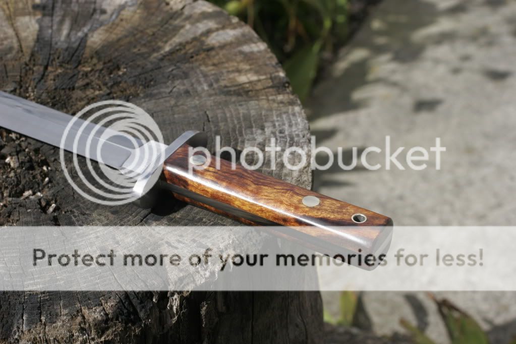

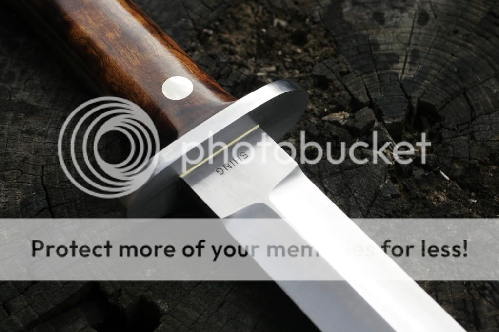

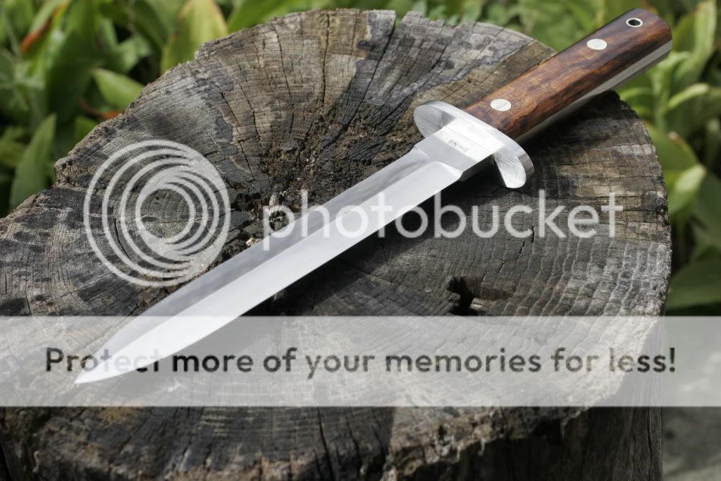

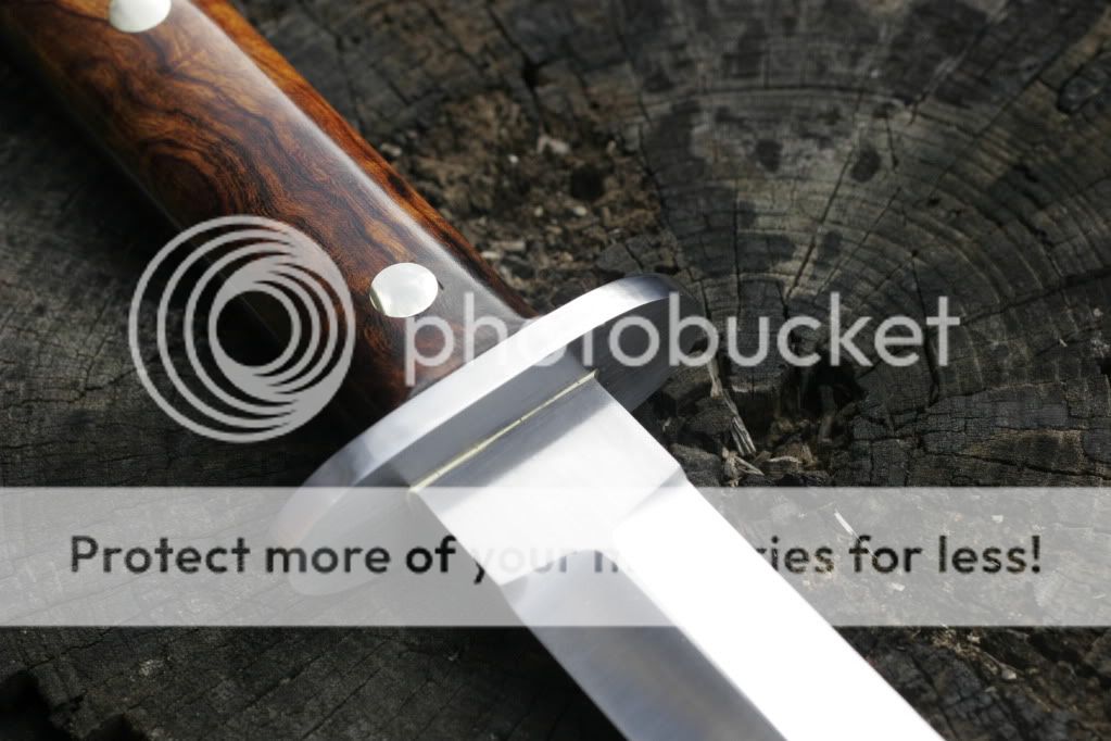

Desert ironwood dagger, 5mm thick, 195mm long OI blade, brazed O1 steel guard, Desert ironwood handle with brass rivets. Its an practice piece for trying out brazing the guard in my kiln rather than use a torch. I left a thin line of brass solder at guard/blade joint to show the technique.
Its going to get a sheath soon.
