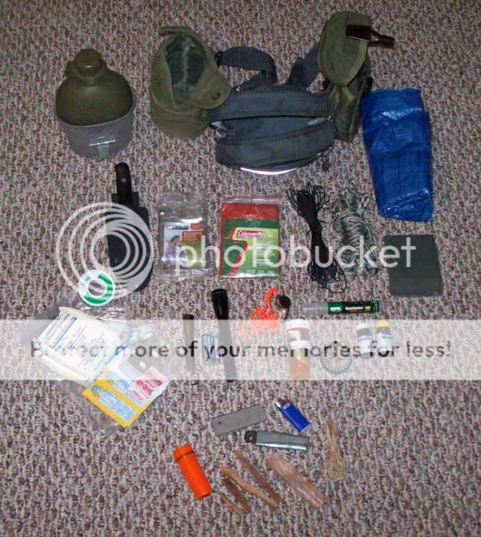

Not quite within your specs ,it is a bit deeper fully stuffed.Just a cheap Walmart butt pack,it does expand outward as it is filled so less stuff equals smaller size. And it has separate sections.
The ammo pouch with tarp is removable,as is the canteen of course.
Everything but the JK Hiker and tin knife is available at any big box store.
Canteen with cup, 5x7 tarp, 165lbs test twine, cheap "paracord", poncho,space blanket,mini-maglite w/LED,spare batteries,LED AAA light.
Pill bottle fishing kit w/line,hooks,split shot,three bobbers. Iodine tabs with neutraliser tabs. Whistle,Compass,pocket bug spray (I hate ticks and skeeters :)),Foam pad with 1000grit paper on one side-400grit on the other.
First aid is Gauze pads,tape,bandaids,neosporin,tylenol,immodium, four chicken bullion cubes(mental pick-me-up)
Fire kit is a mag block,jute twine,fattwood,mini bic,and the match tube is filled with PJBs,and a JK tin knife.
Ditch the canteen, ammo pouch (you also loose the tarp with it) and it almost fits your size. Id say within a half inch all around.
