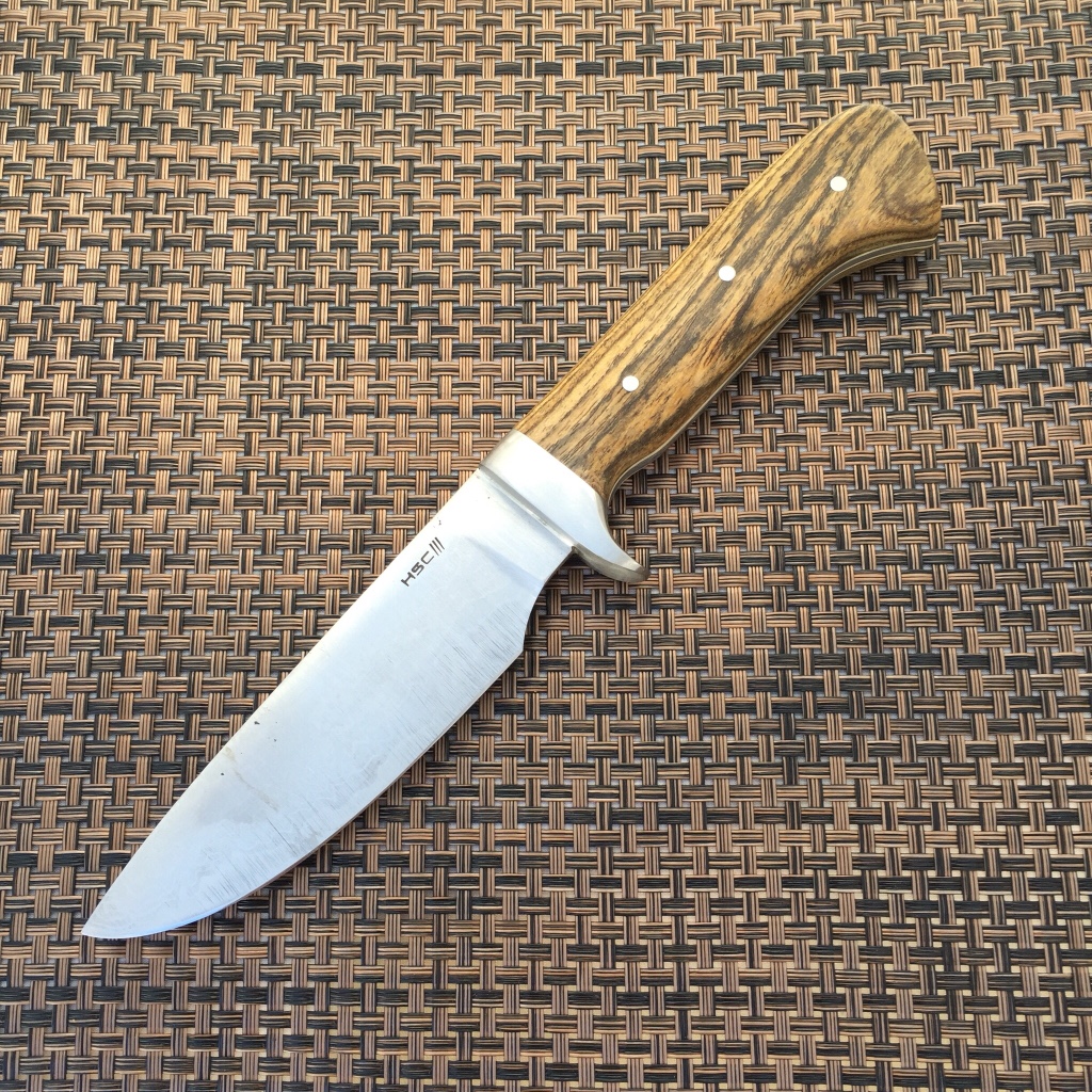

I apologize if this disappoints. Compared to some knives made and sold here, this thing is wimpy. But for me, it is beefy. It will be the beefiest I have ever made.
I think .210" A2 bar stock will be my starting point, and I will go with stock removal, and give it probably a full flat grind.
Backstory: the tooled panel on the sheath was done by my dad about a year ago. Unfortunately, it was part of a kit sheath that was very wimpy. I decided to remove that tooled panel from that kit sheath, and incorprate it into a more substantial sheath of my own design and making.
My dad's health deteriorated over the past year, until he could not longer use the mallet with sufficient force to continue tooling leather. This may be the last piece of leather he ever carved, because he died Sept. 26, 2016. Rest in strength, Dad.
Having remade that kit sheath into something better, I am now designing a knife to go with it.
Planned dimensions:
Blade: 4 7/8"
Cutting Edge: 4 5/8"
OAL: 9 7/8"
Th. behind plunge line: ~.21"
Other notes:
I think I will go with the design that appears in the drawing, i.e., without the finger notch that is forward of the guard. The blade is wide enough I can put as many fingers in front of the guard as I want, and pinch grip it.
Might be a little too much handle, at a full 5". This is just a preliminary design.
Yes, I will improve the black dye job on the leather.
Tang to be pulled through, threaded. I did not show a nut here because I ran out of scratch paper.
I won't shy away from modern materials, so the spacers will be G10 with contrasting colors.
Suggestions welcome.
Thanks for looking.
