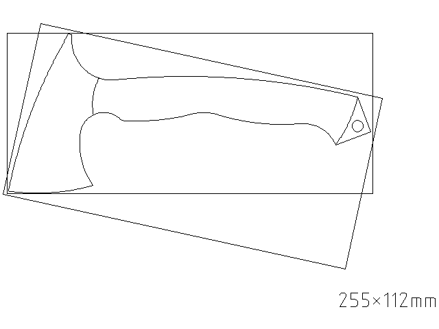

Hey guys.
I have gone completely nuts!
I just finished my first knife (link)
And now I want to try myself on a hawk :p
It will be small, compact and light and inspired by Edwood7's awesome winkler hawks. :eek:
So I popped out a design:
OAL: about 10"
Width tip to tip about 5"
As you can see, I tried to accomondate an ergonomical grip with two different grip positions.
Feedback please!
My questions:
  • Any comments on the design in terms of geometry?
  • Any comments on the design in terms of ergonomy?
  • I want to make it full-tang. How thick would you choose the stock?
  • What type of steel would you choose?
  • To which hardness would you harden it?
Thanks a lot!
Best,
Murphys Law.
I have no input on geometry or ergos but for steel I would go with aldos 1084 - easy heat treat - and make sure you do a couple of cut outs under the scales for weight reduction. The tang should probably be 3/16" or 1/4" thick. The h.t. will be a little tricky. You'll have to do a differential ht to get a 52-55 rhc on the cutting edges and leave the tang fairly soft.
I've never done one on my own but did spend a weekend with my brother working on his. It's a lot of work but worth it in the end.
Just by looking at it (which got a little awkward for me with the two rectangles around it) the handle looks a little odd. The fact that it comes out of the head "backwards" then sweeps forward might make the angle of the head counterintuitive. I would start with the beginning of the handle perpendicular to the head and then sweep forward.
However, you could cut it out of 3/4" (19mm) plywood and see how it handles. Nothing will tell you about a design like trying it in real life. Plywood is cheaper than steel and quicker to work with.
Imagine using the spike, will that handle work with the reverse grip? Make it out of a piece of plywood to test the ergonomics, first.
Overall, I like the design though.

Okay, I redesigned a little.
The first version was WAY to small. this one is 12" long.
I changed the handles to a more universal design, rounded the tip at the butt end and lost the spike.
Why the spike?
I figured I wouldn't need it... ever. Also the removal of the spike would allow me to use significantly smaller stock to grind from.
Plus with the flat back, this axe has a little scandinavian vibe going on. I like it.
Here it is. More testing to come!
Best,
Murphys Law.
I like this one too, like a "francescan", is that what they call them?
A flat back would help for utility chores, like pounding stakes and breaking ice and stuff.
