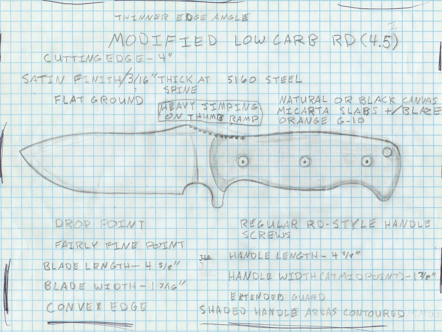

Here's a design I drew up and am having made by Justin Gingrich of Ranger Knives:
AU/CK Design. (Advanced Utility/Carry Knife) I think it'll pretty much take care of being my 'One & Only' medium sized fixed blade. It will be flat ground, convex edged, 5160 with black Micarta handle slabs. 4 5/8" blade, 9 1/4" overall. I've got a few other designs for smaller knives, more like 3 1/2" blades, but I still need to get them scanned in.

I like Kyp's drawing above. In 1095 steel. Micarta. .250 thick.
That would be fine.

I could definetley get into this design, I hope he makes it a production model with the orange G10 I dont know why but thats growing on me
