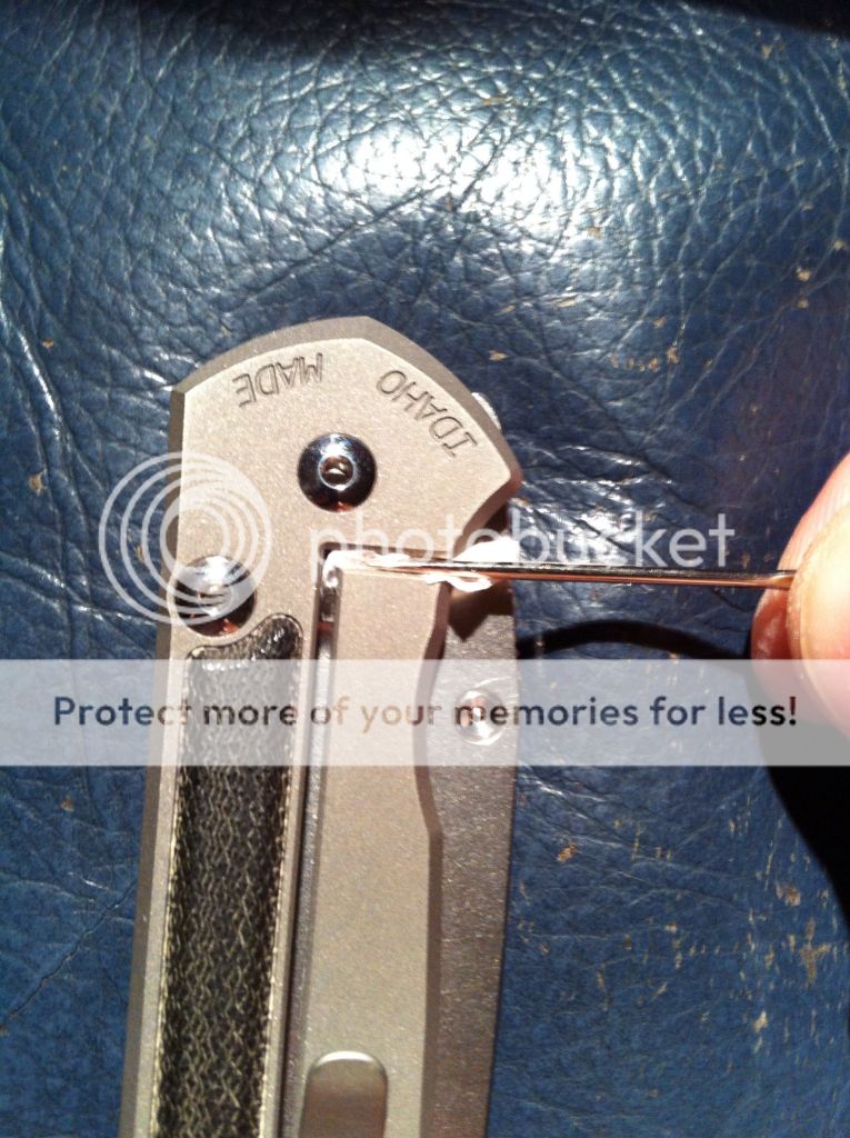

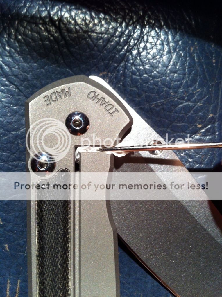

When mine get a little gritty I will use a small piece of paper towel to clean the ball track.
I stuff a small bit of paper towel in on top of the lock bar and put pressure on it with a sewing needle or something similar.
I then slowly open the knife so the ball track gets wiped off.

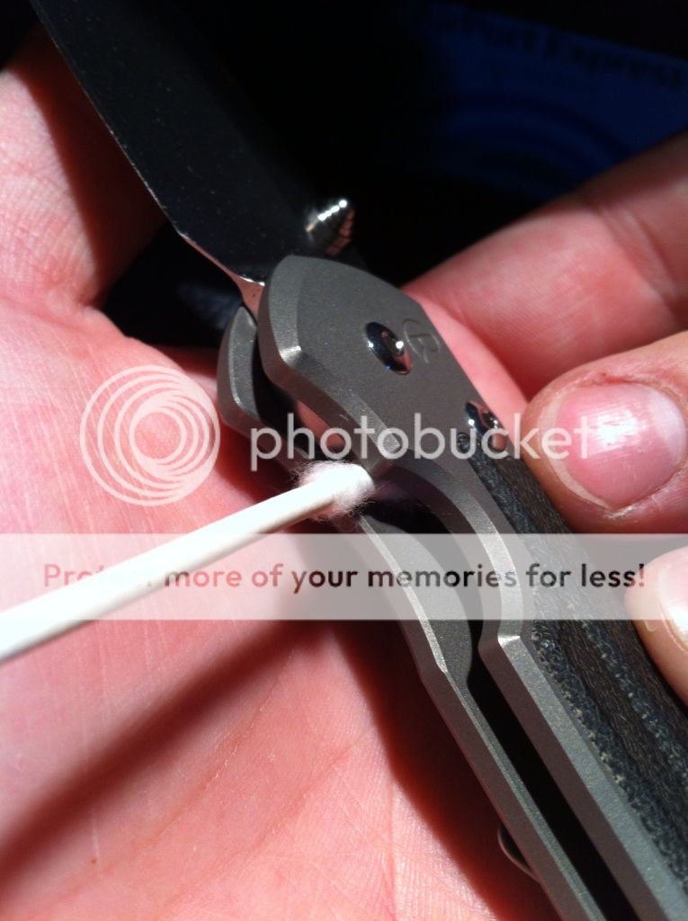

After the ball track is wiped clean by the paper towel I clean the detent ball with a Qtip.

I do this process until the ball track is wiped clean and the knife is back to being smooth.
It only takes a few minutes and I'm back to buttery smoothness.
