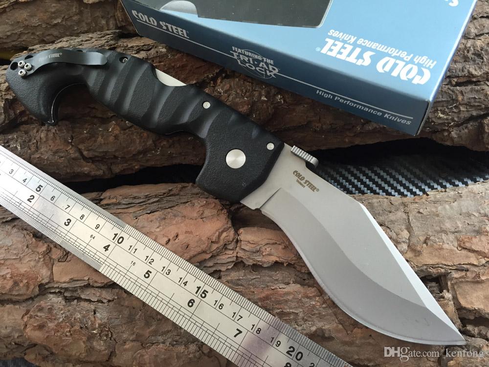

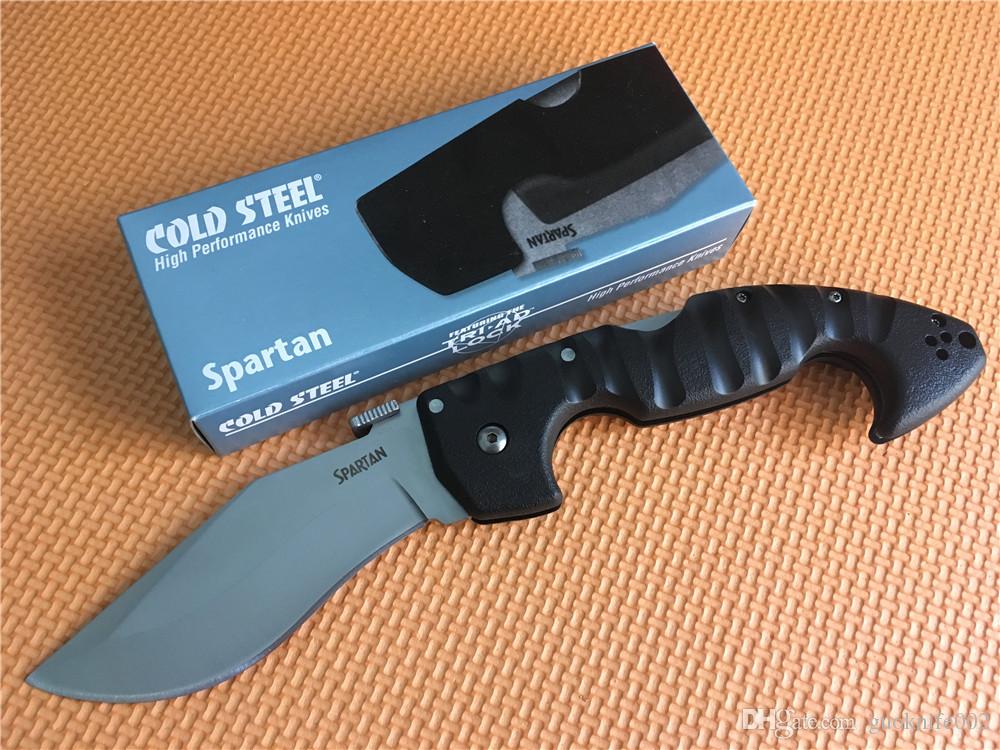

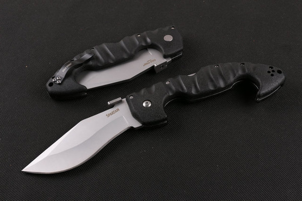

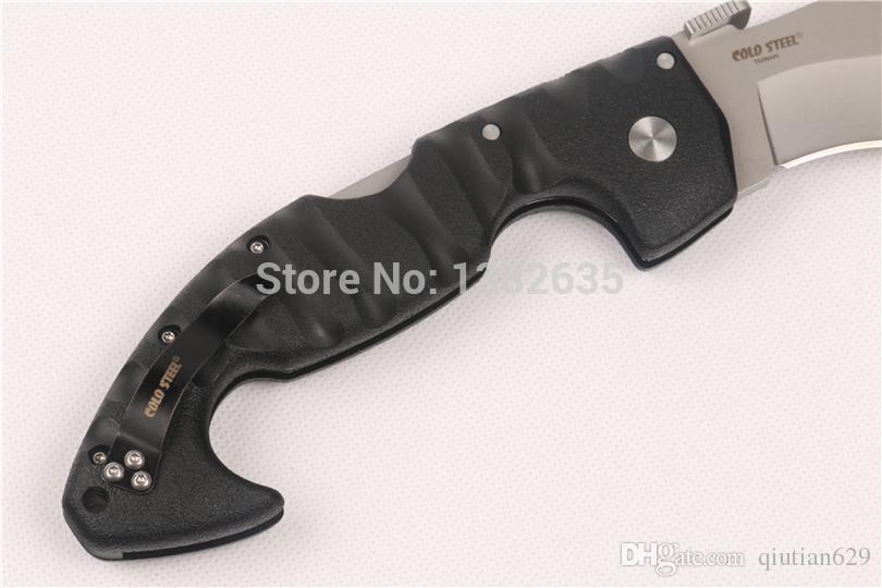

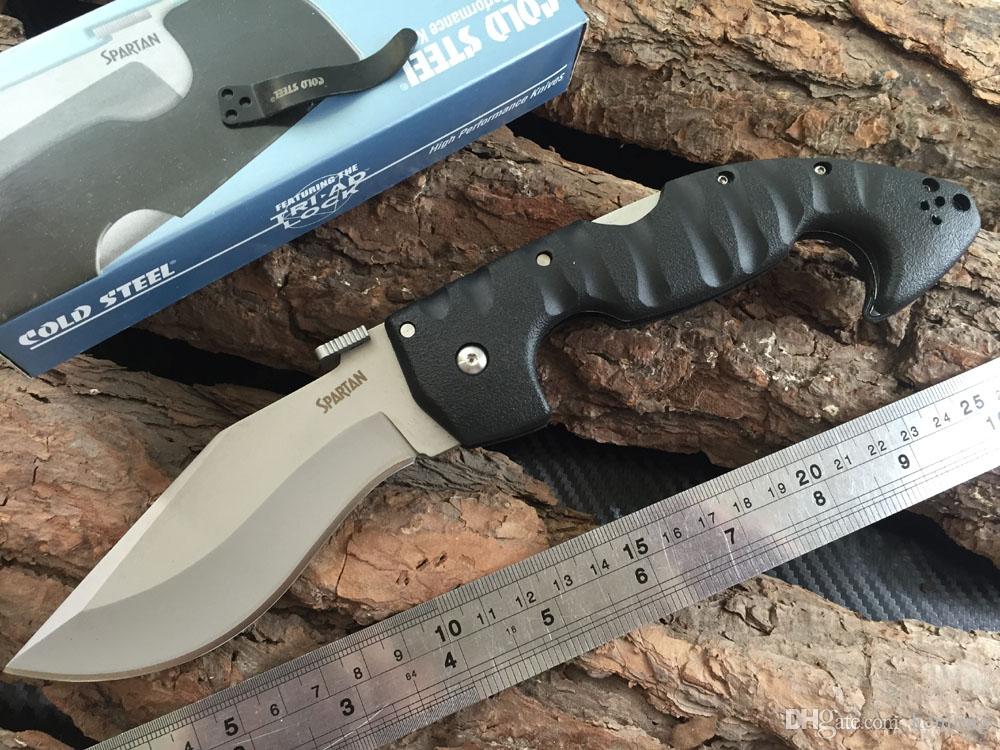

I don't profess to be a counterfeit expert, but I've looked at a lot of fakes in furtherance of my thread on Cold Steel counterfeits. MT, yours appears to me to be a counterfeit:
1) The thumb plate has the wrong number of grooves.
2) The handle scales have the wrong number of texturing grooves.
3) The clip with "Cold Steel" printed on it is phony. The stamped clips are recent, but the older clips (as yours is supposed to be) were black with no logo at all.
4) Clip screws have always been black.
5) Your handle is also too shiny, though I realize that could be due to your polishing efforts.
I don't include more than one photo of the fake knives in my counterfeit thread because doing so would get cumbersome and tedious. But here are more counterfeit Spartans from my archive for you to compare with yours.
