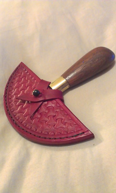

Random pics.
Instructions-
Thin blade stock-
Terrible sheath (will remedy this of course)
Blade markings w/ a little oxidation, no real pitting
The factory sheath probably would have been okay when new but having been snapped closed for years, it's stiff and dangerous. I know if I use it I'd cut myself. Luckily I happened to have a piece of leather and a knife to cut it. ;)
The factory sheath didn't have a welt. Didn't like that.
My first time making a strap, first time using a stud. I like it. :)
Good deal. Use your tooling stone for the skiving, don't need a separate glass surface. Nice job on the sheath.
Thanks guys. :)
Dave, I'll give it a go. Everyone seems to like glass but from a functional perspective I can't see why granite wouldn't work just as well.
I bought a tempered piece of glass 20 years ago. Don't know what happened to it. Don't need it as long as your granite is polished. No difference in use.
