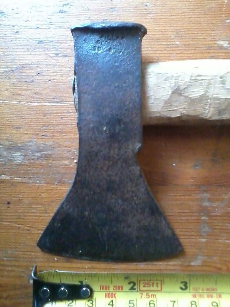

My nine year old asked for an axe for her birthday so I was looking for a small hatchet for her and found this little guy at the local antique shop in Barrie ON.
Here's the head next to a regular hatchet:
The stamp on it says "MILLER OFFICIAL BOY SCOUT" (well, I'm assuming it's an M, it's kind of obscured) which isn't popping up any meaningful hits. It doesn't look like the usual scout pattern hatchet, and there is no crest on it, although I don't know what Canadian scouts used. The handle was a badly whittled stick with four nails in it so any identifying features there are long gone. The steel has a nice ring to it but I haven't sharpened it yet to know how good it really is.
i would grind or file off the mushrooming from the poll.
looks like a nice little chopper
good steel? please post what you find out
The shape looks to be a bit outlandish to have been a Canadian issue or a Walters-made but that's a guess on my part. I was enrolled in the Boy Scout movement (Ottawa, Ontario) from the late 50s to the mid 60s and never saw anything remotely like that at camps or jamborees.
Somebody certainly did pound in a pile of pegs with that generous poll! Some version of hammer handle (check out your local Home Hardware's selection) ought to substitute nicely for a new piece of wood.

I would bet that it originally said WALTERS, since Walters made the Official Scout hatchet for the Canadian Boy Scouts.
From a related thread:
The 'ILLER' part is pretty clear and the head isn't damaged where the 'S' would be so I don't think so, but the shape is pretty close to a couple of pictures I've seen. The blade on this seems to flare upwards more than on the Walters. The stamp on mine is significantly smaller too.

I think you've got it now, Steve. The '__iller' convinced me it wasn't a Walters. And the pattern said 'Canadian' so probably not a Spiller.

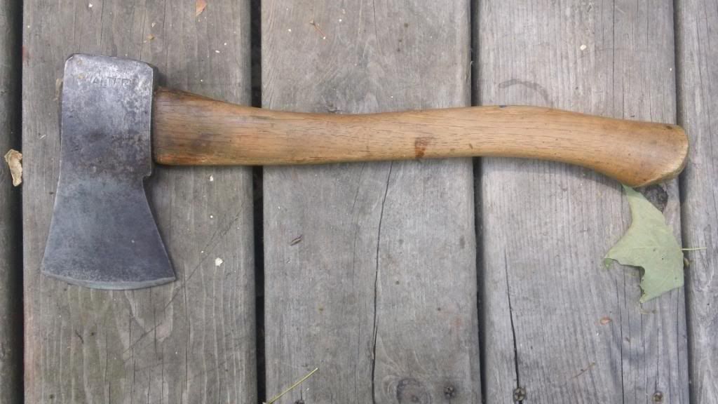

This is the mystery scout hatchet I got for my daughter. Unfortunately the Canadian Scout museum wasn't able to shed any more insight on it but it seems to be from somewhere between the teens to the thirties.
A regular hatchet handle would have been too big so I hung it on a 13" hickory ball peen hammer handle from Princess Auto, sanded it down so I could stain it blue like her other tools (her favorite color) and soaked it in Tung oil for a day. She would have been happy with anything since it's her first axe, but it is actually a very nice little tool. The steel is excellent and the balance is quite good. Fortunately, she lets me use her stuff :D.
Very nice to hear back from you on this! Looks to be you did a wonderful job of cleaning up and resurrecting that 'old girl'. I like that handle. It's a real bonus there are stamps on it which someday will enable your daughter not only to fondly look back upon a well loved childhood memento but be able to research that it's way older than 'dear old dad' and that it never was a dime store item with fleeting purpose or value either.
