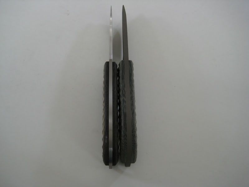

The boney active duty is thinner at .125" thick and the active duty is thicker, at .150" thick. Everything else is the same besides the thickness of the blade.
BAD is thinner, and hardened 2 points higher than most INFI for better edge holding and slicing geometry. It is not designed for hard use but still carries the same warranty

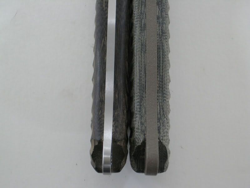

The AD and it's variants range in thickness from the .205 HD down to the .125 BAD, as was stated, the BAD's run 61 -62 Rockwell. The BAD's are flat ground, the other AD's are all sabre ground.
The original run was .150, the Milly overrun was ~.195
CS AD .150, HD .205, MAD .195, MAD .195

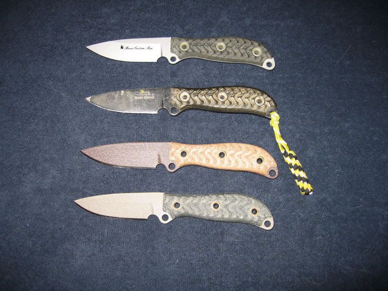

BAD verses Military overrun AD
Besides what Jimmy and others stated above there were a few AD's that were flat ground out of same .170" stock as the .170" leaner that came from 1st Easton show

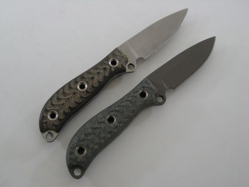

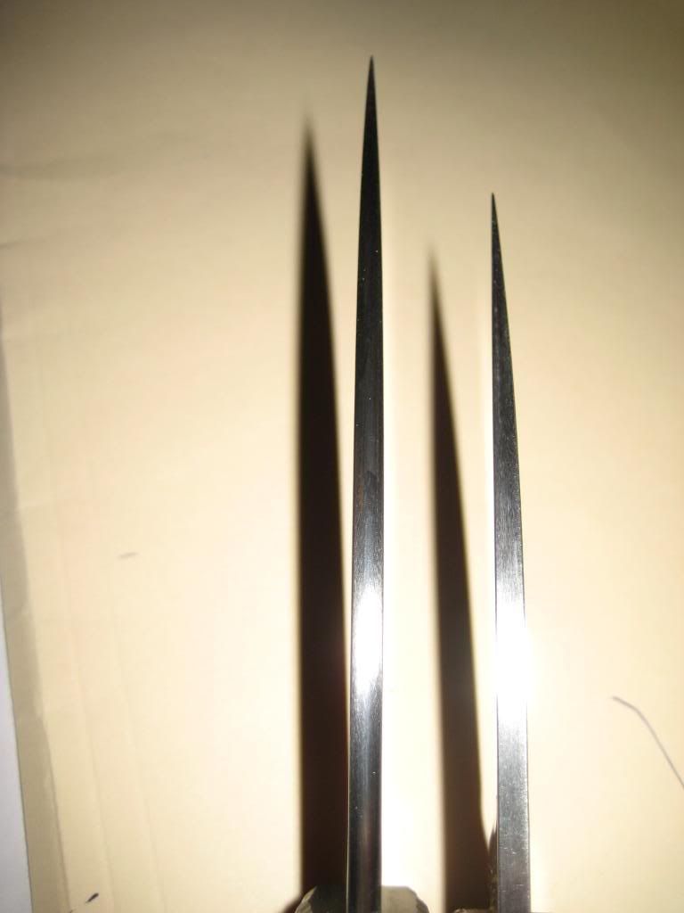

You can see the sabre in this .150"
and here are a couple original HDs

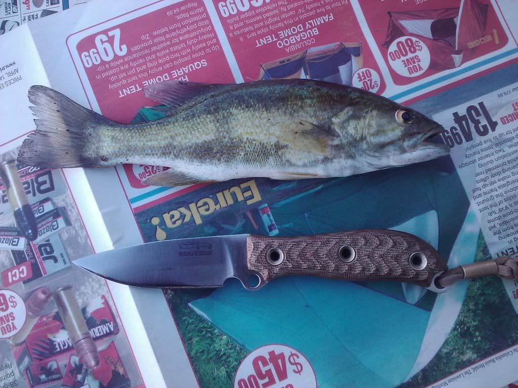

Pic with my 6 year old's first fish.

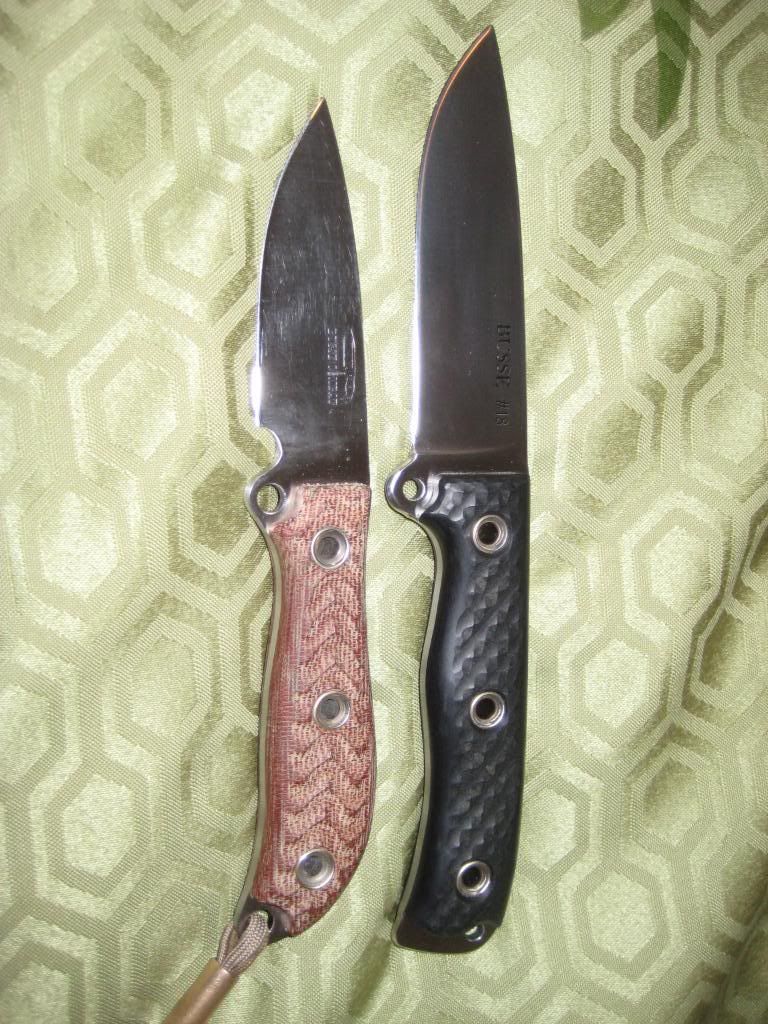

comparisons with a CABS (another slicey pointy cutter!)
