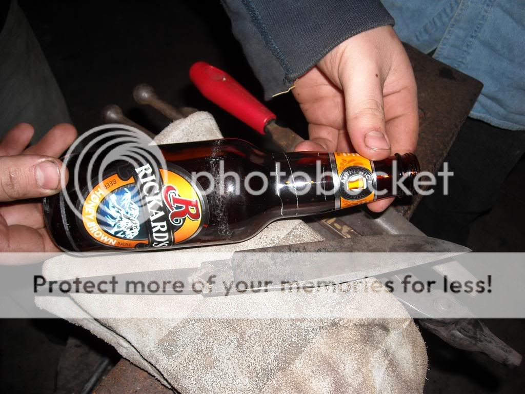

Chipping, rolling and flattening are the result of heat treating and tempering not so much edge geometry. Kevin Cashen has some interesting ideas on heat treating blades and foregoing tempering. Below is a picture of a blade from Ashokan 09. The edge must be 67RC or better to perform this.
Johnny
Johnny
Impressive:thumbup:
I must have missed something... all I see in that pic is a guy holding a beer bottle (mmmm... Rickard's) next to a file, a glove, some pliers, and a knife without a handle. Unfortunately someone's gonna have to spell it out for me.:o
Take a look at the bottle neck below the label.
Johnny
Okay, it looks cracked. Maybe my monitor sucks, but I still have no idea what's going on there:confused:. Can someone please tell me what I'm supposed to see and why it is relevant or significant?:)
