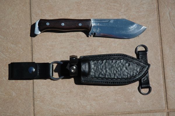

Hey All,

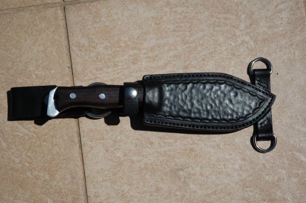

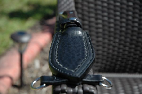

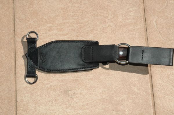

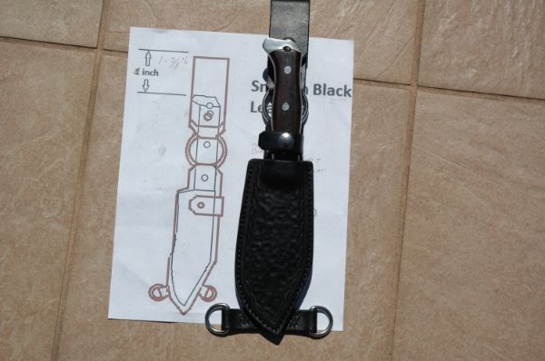

Been busy finishing up my move and a few projects, just finished up a sheath for a Mini AK Bowie for a friend of Ndogs. He wanted a dangler type sheath for his blade using a circle ring instead of a d-ring and wanted two smaller d-rings at the bottom for a leg tie down. Ndog sent me a drawing of the sheath and after a few small mods we came up with a pretty cool design. Being a dangler style we had to figure out proper retention the wet molding would work but his friend is going to be riding with it, and did not want to chance it coming out, so I came up with a little wet mold at the top and just above it the retention strap, this baby is not going anywhere. Wanted to post this cause its a tad different then the norm. Let me know what ya think.

Very fine job Pugs! I think he will enjoy it. Thats exactly what he wanted! The idea was when he sits on his bike the ring would act as a hinge and since its leg tied it should ride snugly sitting or standing. Your addition of the wet mold on top was a great idea! He dont know about that yet but im sure he will like it. Cant wait to see it myself! My friend will take a ride up to Montana from Texas later in the month so it will get plenty of testing. Ill report back when he returns!

The wet molding acts as a good funnel to guide the beast back into the sheath. I think it should be a rule or something.
