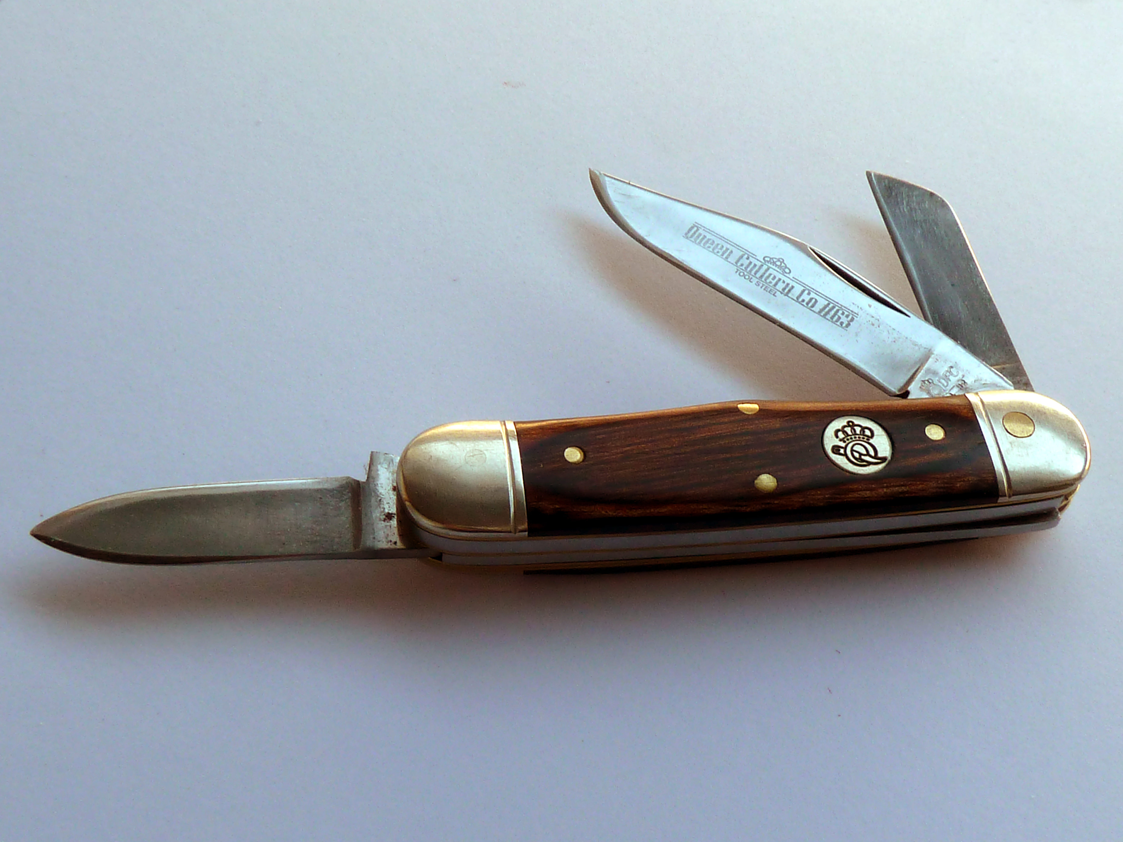

I have Queen Cutlery Railsplitter knife for one year now. It seems the blades are made from different types of steel, pen blade and coping blade have after a year of use a dark patina, the big clip point blade behaves like stainless. Any information about this? (All blades are original from this knife. Big blade was nailbraker – it was removed and mended - that's why a new rivet).

That's really odd. Do the two smaller blades respond any differently to sharpening? Does the Clip blade seem harder to sharpen than the other two?
If so, they may have accidentally slapped a couple of carbon blades on your knife. They do offer some Railsplitters with carbon blades. Could be that they got them mixed up when assembling your knife.
I have heard on some designs they only use the D2 on the main blade and then something different on the others but I've never seen an example of it. It would be obvious the difference when sharpening the D2 steel and the others if they are a carbon like 1095 as the D2 takes a bit longer to get sharp and will act differently.
Depending on when this was made, like shortly after the Daniels family bought Queen, they were trying to get rid of stock and they used up whatever spare parts they had and kind of made some franken knives. I'm curious if this is kind of what happened, a lot of carbon blades a few D2 main blades left when they bought the parts stock. Pure speculation on my part but I think it's possible.
I don't know the why behind it, but that has to be what is going on here. D2 and 1095.

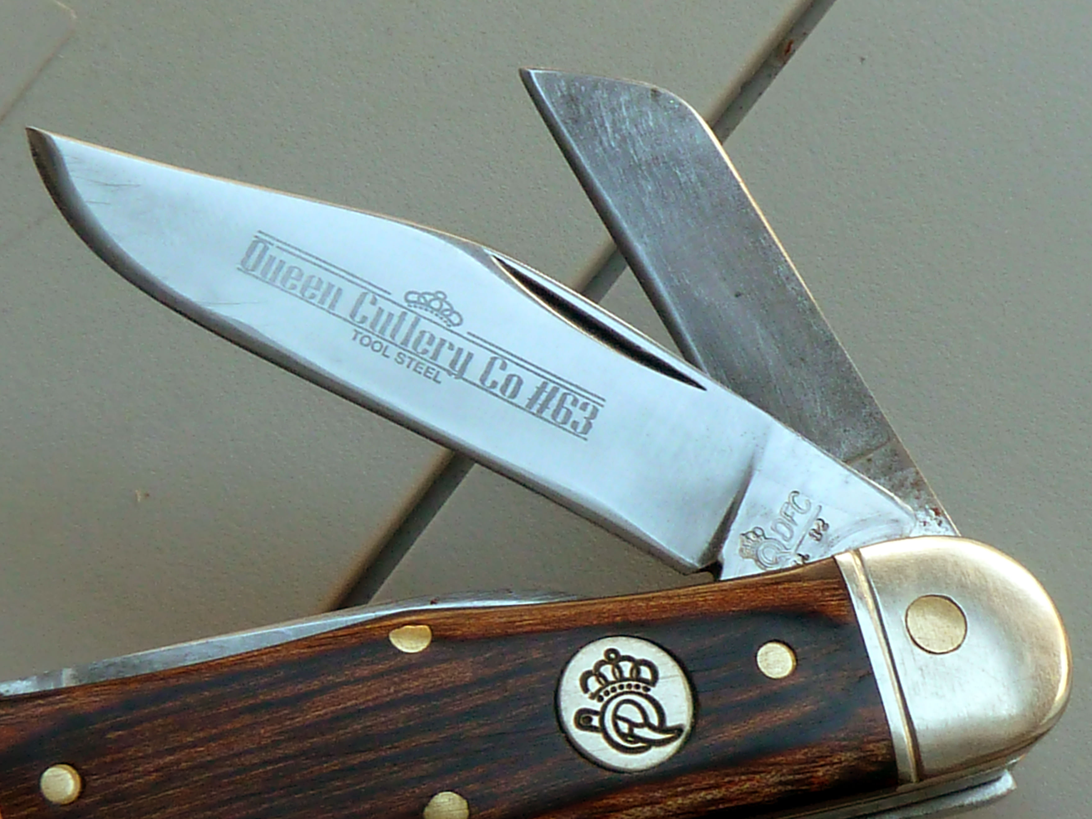

The Main is clearly stamped PH-D2 which means Peters Heat Treating, the company both Queen and GEC use for heat treating their blades, and D2 which is what that blade steel is. As has been said, obviously the secondary blades are not D2 but most likely 1095, if they were 420HC they would not have that much patina.

Anyway, I've got a 2014 Railsplitter in my pocket right now with D2 blades. There are no markings whatsoever on the secondary blades. Just the Clip blade and it has the markings that Dave described above. I'm pretty confident that all three blades on mine are D2 as they all respond the same to sharpening.
An easy way to check the blade steel on your secondary blades is to dip just the very tip/point into vinegar for 10 to 20 seconds, if they form an instant patina they are most likely 1095. By just dipping the tip you can shine it back up with a very soft scotch bright or with a little more effort use a simply polishing cloth.

Along similar lines, I've just used a Q-tip to dab a little white vinegar on a small area of the blade. If it's something like 1095 or CV, you'll see the spot go 'gray' pretty fast, in maybe ~5 minutes or much less. AND you might smell the reaction too, if you put your nose to it. Make sure the blade is clean, with no oils/waxes/etc, before doing this. D2 won't be fazed by such a minimal application of vinegar in that short time (I've tried it with my Queens).

Queen's D2 also often has an orange peel finish to it (hard to see, but there), while 1095 usually finishes very smooth.
