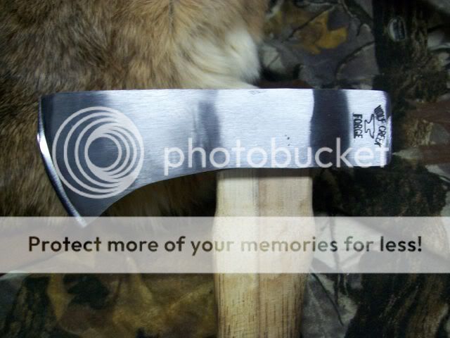

We dont make that many mono-steel head hatchets/axes but heres on I made a long time ago..Its made from 4140. If you look you can see the temper line about an inch back of the edge. the edge and the poll face were hardened and tempered..Edge tempering is easier than hardening the whole head and then drift tempering or oven tempering..To me it is anyway..I personally prefer welding a bit in myself..
