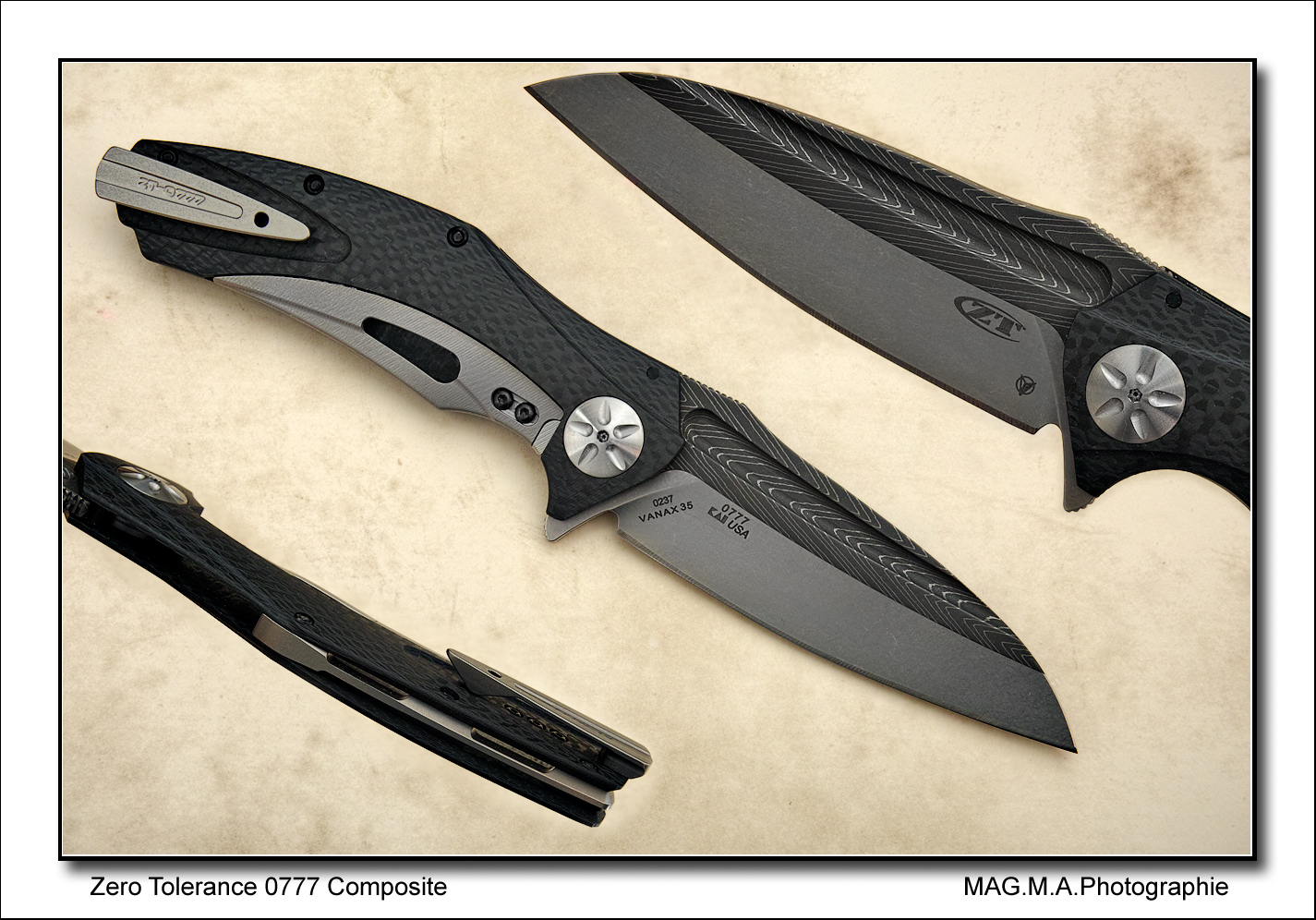

Hello!
I can only second STevens recommendations, ZT would probably be your best guess. Here are two of mine, the composite is more visible on the 0777 with the damascus section, but the 0888 also features a composite blade. There are quite a few other and more readily available pieces as well though.
