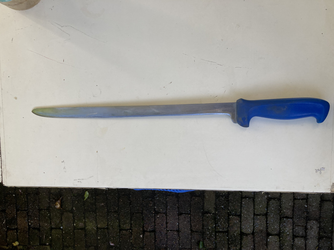

I am having a terrible argument with a shoarma knife that refuses to get sharp. His younger "brother" (same knife but less worn out) was no problem at all.
The problem knife is worn down to almost half the bevel size. I tried everything I know. Firstly grinding what once was a secondary bevel down to something acceptable since the wearing down made all angles too obtuse (wide). Then the primary bevel still wouldn't get really sharp. Rough stones, fine stones, stropping, machines (Tormek T4 so not a crappy machine) diamond stones… Everything would not get the job done properly.
Any useful help is greatly appreciated!
Now that I found how to upload; this is what I a talking about:
